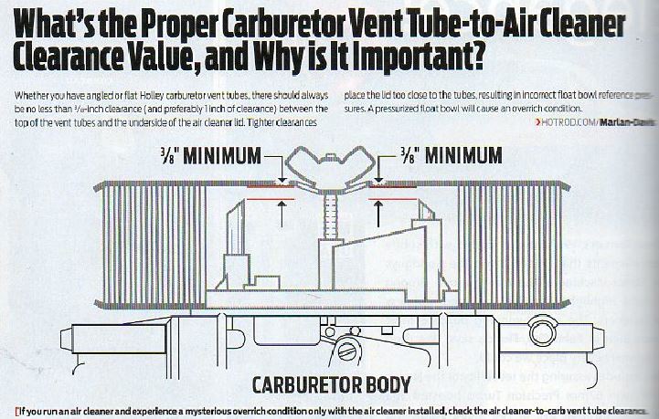

Originally Posted by L78steve View Post
Not to start an argument but I believe the raised bead on the floor of the base is for improved sealing.
I cannot see how that would improve airflow.
I believe under certain conditions there was an air flow restriction with the original flat-bottom. Elevating the lid would eliminate the problem.
I have had several flat bottoms and the element sealed to the base just fine.
