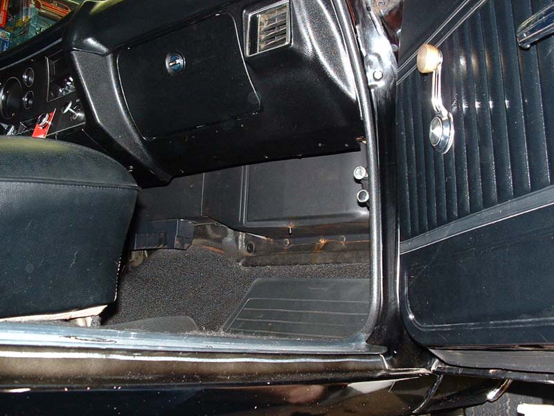

Anyone know what color the heater box above the passenger feet is? Is it black or gray or phosphate or what? 1970 chevelle?

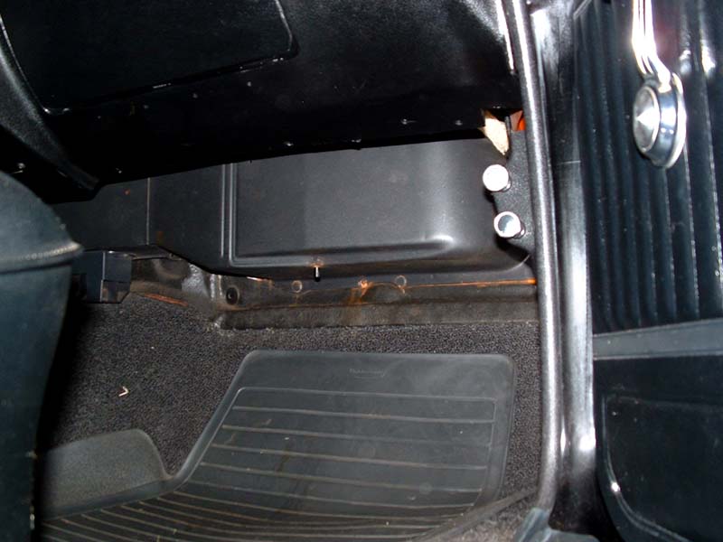

Mine is Black; probably around an 80% gloss. Not a real good shot, but maybe this will help.

I think he's inquiring about the part that mounts on the inside of the firewall [img]/ubbthreads/images/graemlins/blush.gif[/img] Probably called an 'air diffuser' or some technical name like that.

The box has a slightly textured flatter black look to them. On survivor cars I have seen it is very dull and slightly textured almost like a 'dry' spray. That is how I restore them.
With regards to the firewall side, I think they are originally even glossier than 80%. On low mileage cars, flip the cover over and you can see that they are very gloss, closer to 90-95%.

Oops, my mistake. [img]/ubbthreads/images/graemlins/blush.gif[/img] You're right about the "textured" finish on the inside piece. I probably have a shot of that too, and will get it to you soon. Sorry for the screw-up.
