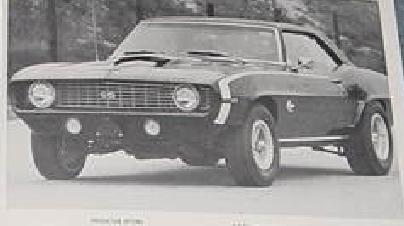

Some of the 69 Motion Camaros used the Traction Master bars. This was a round bar that used a bracket that mounted to the spring plate in the rear. The front bracket mounted to either the front spring mount or some type of spring clamp. I have a set of NOS Traction Masters for a Chevelle with 24 in bar that I think can be used. You would need to fabricate new mount brackets because the Chevelle ones are different. You would need to fabricate a bracket to work around the sway bar. I remember seeing these types of bars used with the sway bar. see pic of Motion car with round type traction bars.
