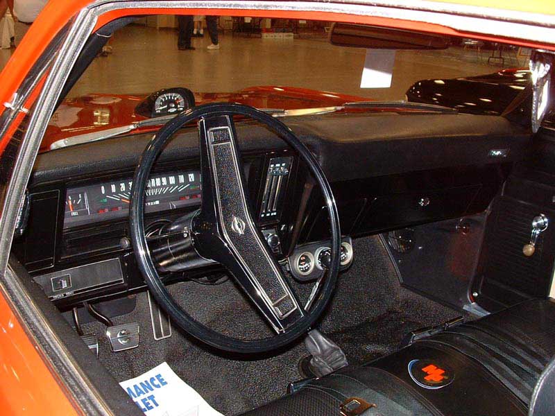

Joe,
Not too good but here's a shot of Tommy K's car.
DC

Default Re: Yenko Deuce Shifter info/pic wanted
That must be a Motion Yenko Deuce since it has the MP on the seat!
Marlin
