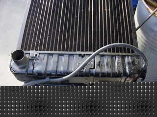

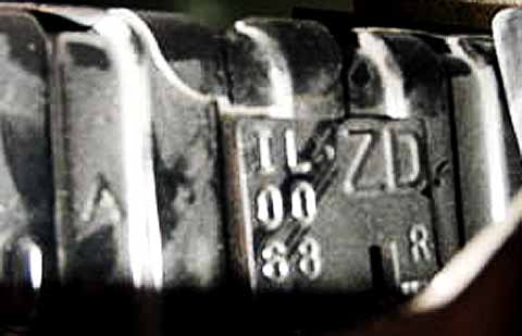

I have been looking for an original Harrison radiator to go on my 69 Camaro 396/375 with a manual trany and been told that I need a "ZD" coded tag, 3 core with a straight neck. I have talked to quite a few people and everyone seems to tell me something a little different as to what is stamped on the tanks. I didn't find any information in any of the books I have so I figure this is the place to get the answer. I have found a source that has original Harrison tanks but I want to make sure I get the correct one I need. I'm sure someone on this site has the knowledge of the correct answer.
Does anyone have a photo of the radiator I'm looking for?
Attachments - The Supercar Registry 27642-DSC00228.JPG 27579-rad.jpg 27572-DSC00209.JPG 27565-DSC00209.JPG

I can't vouch for it being original to the car, but my L78 Manual has a correct three core Harrison "O" A "O" raised on the filler tank While the 4 core original Yenko radiator looks like "O" K "I" and they both say FILL ^ COLD and have an "R" on the Driver side tank Brace.
Of course both have "Harrison" Raised on the Filler tank.
