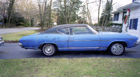

The good ole Bronx. Dunno if you can read the print on the side but they say Jun 69. It was purchased 6/6/69. So she was new and PURDY. Unlike today. See attachment. [img]/ubbthreads/images/icons/frown.gif[/img]
