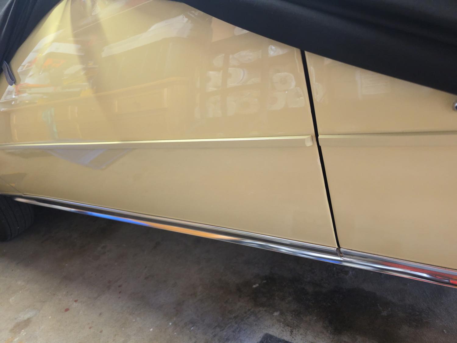

Considering the above small block 4 speed. Largely original car. Car has stock non power drums. How well do these stop on a 67 Camaro? I have a 69 Charger RT with non power drums so have some experience but those pads are 3” wide but a heavy car. Any commentary?
The tranny is a M20 with a 3.73. pJ coded and dated to the car. Would prefer a 3.31 gear. I expect first will be a little of a granny gear? Any thoughts around this?
Thanks
Lawrence
