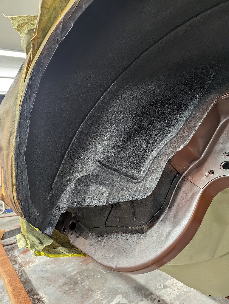

what is the best product to use on the rear inner fender wells for a heavy coverage i am using a schutz gun

Same product that gun is made for: 3M Body Schutz

Had my painter use 3M 08804...........Would still like MORE BUILD
but not sure if adding more is the answer????
The 08804 Dries Hard..............Whereas I felt a LEGENDS 70 Camaro
Wheelhouse while at the 2025 Camaro Natl's and dont think the
RUBBERIZED product is Corrrect vs Assy Line Original ???????

3M applicator gun part number 8997.
Summit: # 3M Products Body Schutz Rubberized Coatings 7100070546
You obtain a nice course texture and great buildup.

how does the 7100070546 dry

7100070546 (Summit) is 3M # 08864 Body Schutz
I really liked this comb as I could adjust the spray/out appearance via Air Pressure, Distance, & Speed and layers can be added.
It does take a fair amount of time to tack and fully cure.
