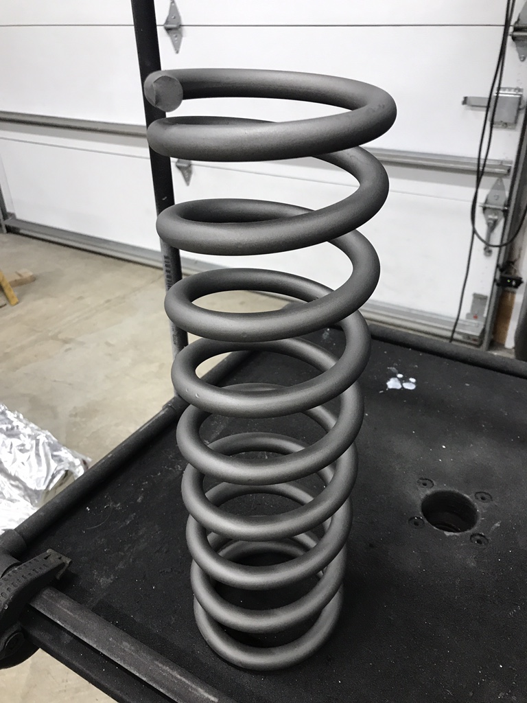

I got a used pair of correct factory F41 coil springs. These fit 72 Nova SS Model. What color paint was used for these coil springs?

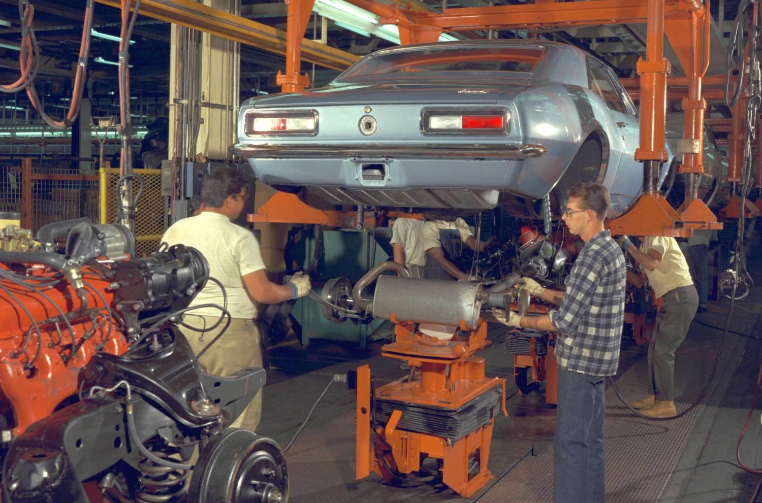

Not sure it helps but these look natural grey.
Note upper ball joint is not painted either.
Some overspray on exhaust manifold also.

Thanks Dave, great vintage picture. Believe 1967 Camaro, i dont see side marker light but could be blocked by the bumper. Anyhow appreciate your help.

Chassis is 67 full size.
Just pointing out the springs look un-painted.

Looks like vent windows on the camaro so 67

Glass beaded mine and shot with C-129 Stainless Cerakote

^^ That looks really nice.
