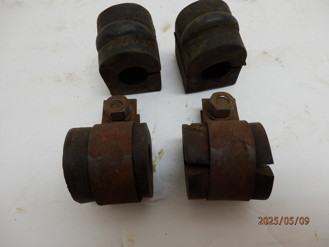

I couldnt easily find a installed photo in my huge collection of files/photos............
This is the Rubber That is held on by a small sheet metal band and bolt/nut to keep the bar from moving to the right (Please correct me)
I have new Rubbers measuring approx 5/8" ID , 1 1/2" OD & !.400 Long............
Are these rubbers easily found where ??? As I dont know if I have something of much
value or not ????
Does anyone repro the Steel Band ??
Thanks for the education

I've never seen the rubbers as replacements, are your nos or some rubber product that is a very close to the dimensions? Metal bands are reproduced with the usual guys.
If the rubber is generic, can u let us know where you got them?

Eddie & Others...............There is no part number on the above rubbers.......
Ive had them four a very long time and dont remember where I got them...
Waiting for someone to confirm that these rubbers are for the 69 Camaro Sway Bar
as I do have two VERY USED Metal Clamps also..........

here are the brackets - HBC sells the bolts as well
https://www.heartbeatcitycamaro.com/...lxBArVDxUYXlEz
I'll see if i can get a measurement for bushings.

maybe these for a nova -

I have a pair of originals

Jeff, can u provide a few dimensions pls

The original clamps should have a letter "P" stamped on them.

I do have 2 Original Clamps (Too Damaged to Be Used) .........On one I can see the "P" Stamping...The Other has too much Paint Over The P area.....Somewhat interesting that HBC Offers a repro clamp set, but not the RUBBERS......I have SIX new Rubber Pieces

I’ve been looking on McMaster-Carr for something to make some of these rubber things. Got a couple ideas.
