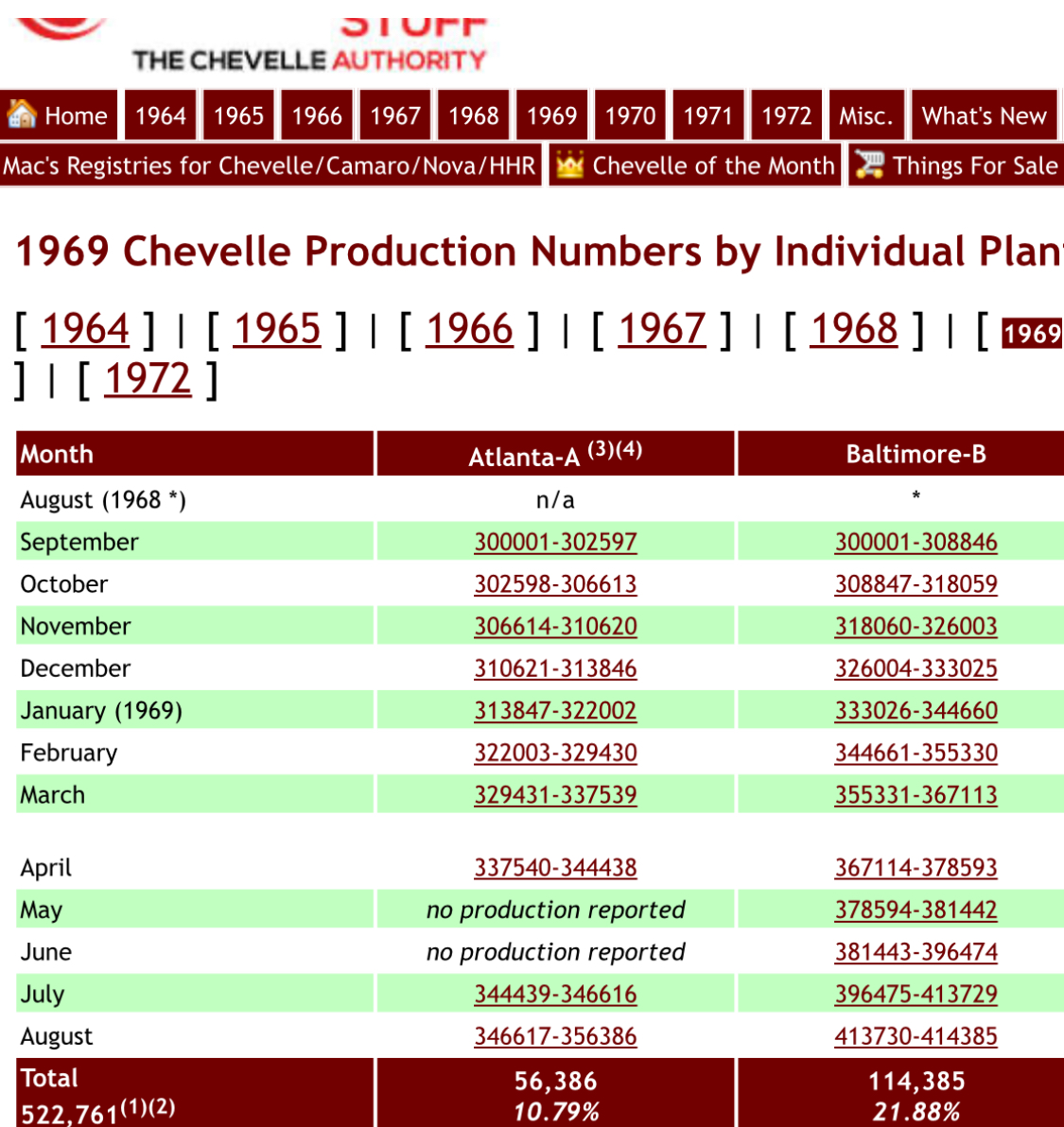

(1) I don’t see any broach marks on the pad.
(2) That VIN is for a March built car but the stamp is May 23rd.
(3) The casting date is on the side of the block and should be back by the bell housing. Tonawanda switched that earlier in the year…..I think sometime late January earlier February….?
Kurt
19B363798
T0523MP
