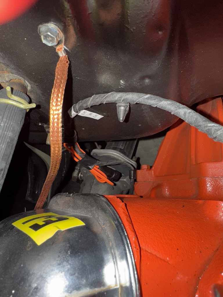

There is an orange wire running through the firewall gutter that has been cut and folded back into the gutter.
My first guess is that I need a new rheostat. Anyone deal with this recently?

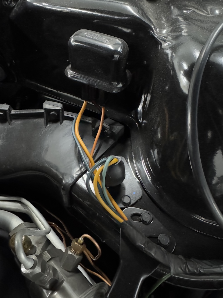

This from a '67, but guessing '68 is similar if not the same.
The a/c rheostat is easy, right up on top. That orange wire in the engine harness powers the blower motor on non-a/c cars, it is typically coiled up and taped to the harness unused.

'68 was a complete redesign of the A/C system and firewall. It does use the same relay and appears to be mounted on/near the housing in this pic.

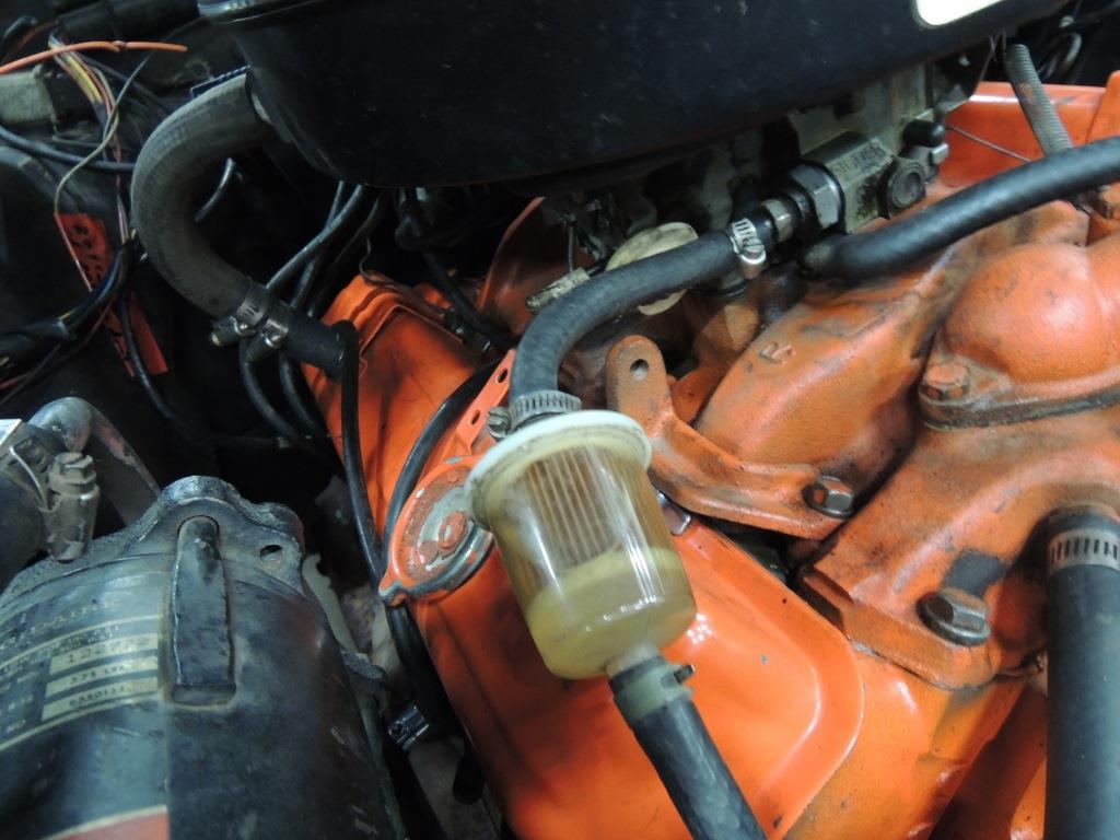

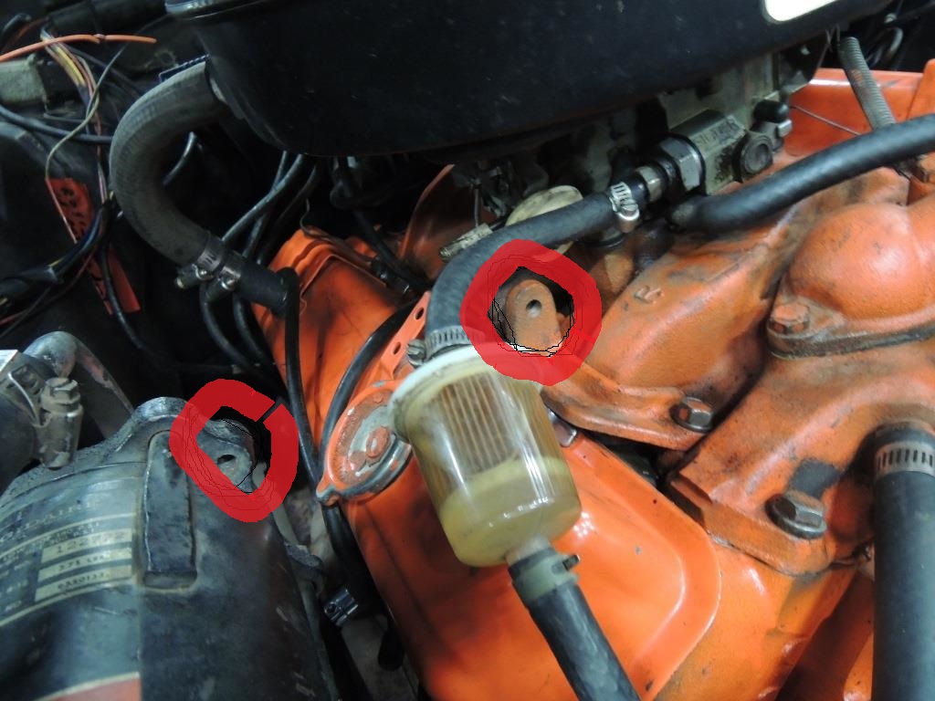

Default Missing bracket
Also missing one bracket. Goes from the threaded hole on the compressor (circled) to the threaded hole in the bracket on the intake (also circled).
I am sure it is similar to the one on the 67 above. But, mine is a small block.
Anyone have that bracket for a small block 68 vintage.
