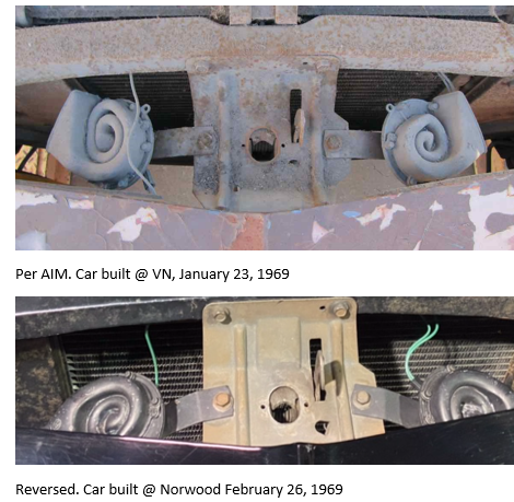

I am in need of a 1969 camaro drivers side horn I believe it is the high note???
I have the correct passenger side horn, just need drivers side.
DM me if you have one you want to sell, if none come up The repop set from Classic industries is only $150, has any one used them?
Thanks Dan

Best be more specific. Horn position was reversed in production late January-February 1969.

Well damn, I will check today when I go to the garage.

Trumpet turns counter CW on the high and CW on the low center out.
