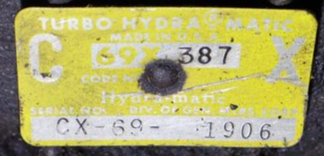

Hi All,
Is anyone reproducing the CY transmission with VIN stamp?
Thanks,

Never saw a tag with a VIN. They were stamped with date of manufacture [387 = 1/21/69], trans suffix & serial number. The blank CX tag was reproduced years ago; stampings had to be added.

PartsPlace,(now owned by Classic Ind.) over here sells all the blank GM Auto Trans codes. https://www.ebay.com/itm/33349024477...lleKh8v&edge=0

Thanks William. This is our first direct experience with the M40 and I was confusing the date of manufacture with the VIN.
