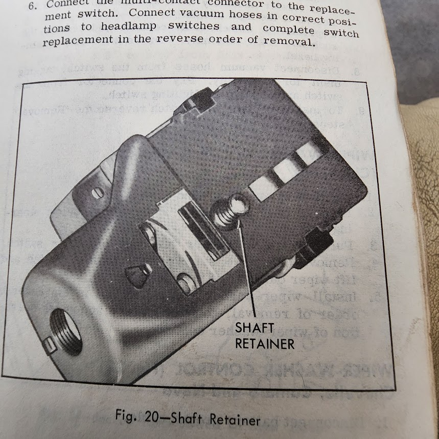

Here is the button to release the knob and shaft.
