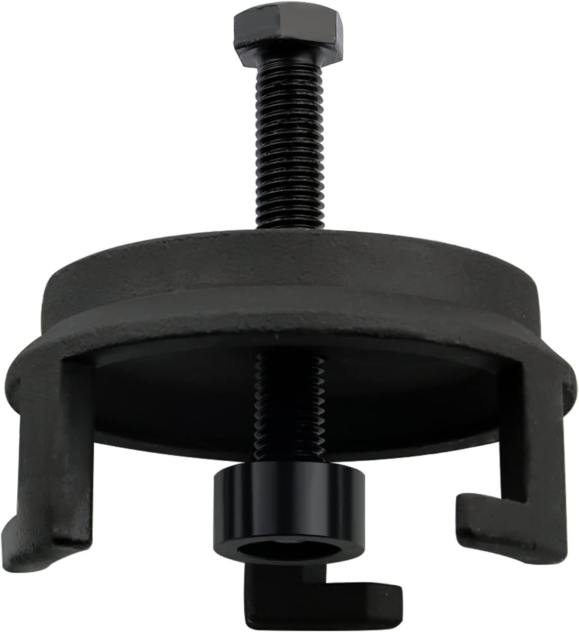

Need to pull the crank pulley (given the construction, I have a hard time calling it a "damper"). Got out my 50 year old SnapOn crank puller and was surprised to see NO threaded holes. WTH. Got out an old hub puller (Bonney) and DID figure out a way I could use it, but I would have to cut three 1/4 inch plates and drill them for 3/8 bolts. Seemed like a lot of trouble. So...
I bought this POS from Amazon. https://www.amazon.com/dp/B0CBRKZ6MF...sin_title&th=1
No Freakin way does it work on this pulley.
I KNOW a LOT of you guys have LS experience.
Point me in the right direction. Which puller do I need for this job.
Thanks in advance.

It's not the cheapest but I like ICT Billet's stuff:

Auto Zone will rent you one, best bet.
I have a feeling you won’t be doing this again.

Only problem with some of the rental tools is you need the center bolt to be kinda long.

found this on Amazon $30 can't speak for quality

That looks just like the one I bought and sent back.
It did not work. It said it fit GM, Chrysler and something else.
Ordered an adjustable one similar to what John posted. Will try it out this evening.

Bought this one. Worked fine. Only has about 1/8 of an inch of engagement for each hook; but it didn't slip.
Figured I might be doing another LS at some point, but didn't see a need to purchase a high end unit, as I won't be doing very many. I would much rather work on the vintage stuff.
