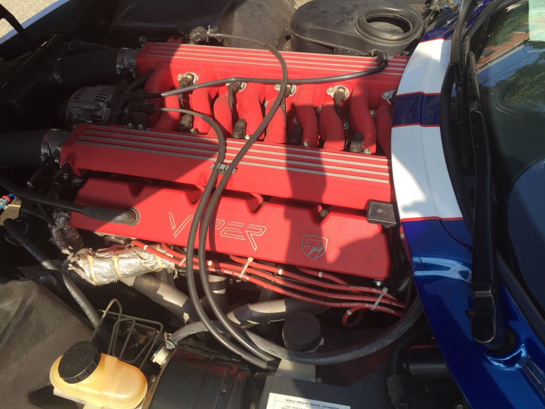

I pulled the cover off my own garage find today and decided to do an oil change. The last one was 9 years and 194 miles ago. After a brief battery charge she started right up. The oil that came out looked and smelled fine, of course. All ten quarts. And I was reminded how the wonderful oil filter set up was designed to apply liquid rust proofing right onto the passenger side frame rail so it can run all the way down both ends of the frame rail, avoiding all sorts of strategically placed drip pans, rags, and cardboard.

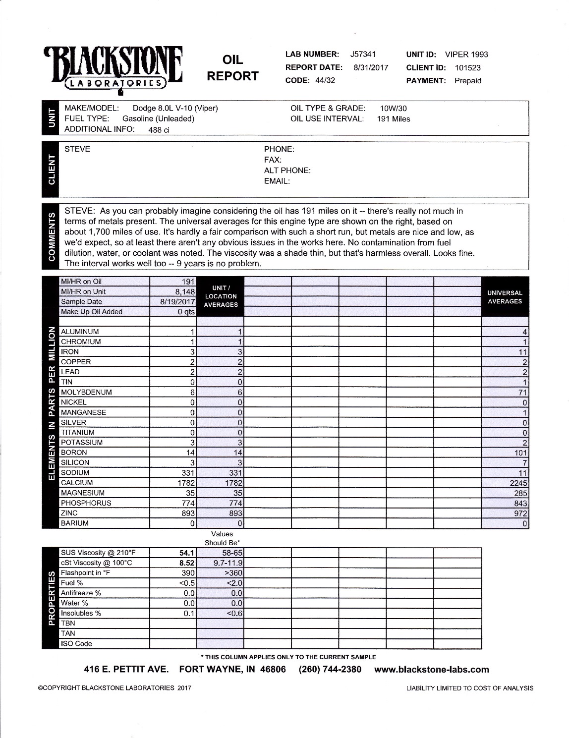

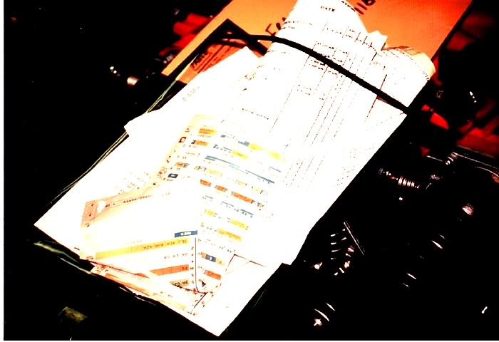

I got the oil analysis results from the 9 year old oil (only has 191 miles on it). Looks like that old adage about having to change your oil every year before you store it, is something of an old wive's tale. Since there is no moisture, corrosion, fuel or coolant present in this sample after almost a decade in a non-climate controlled garage, and running it maybe once or twice a year.
Here's what nine year old oil looks like when analyzed:

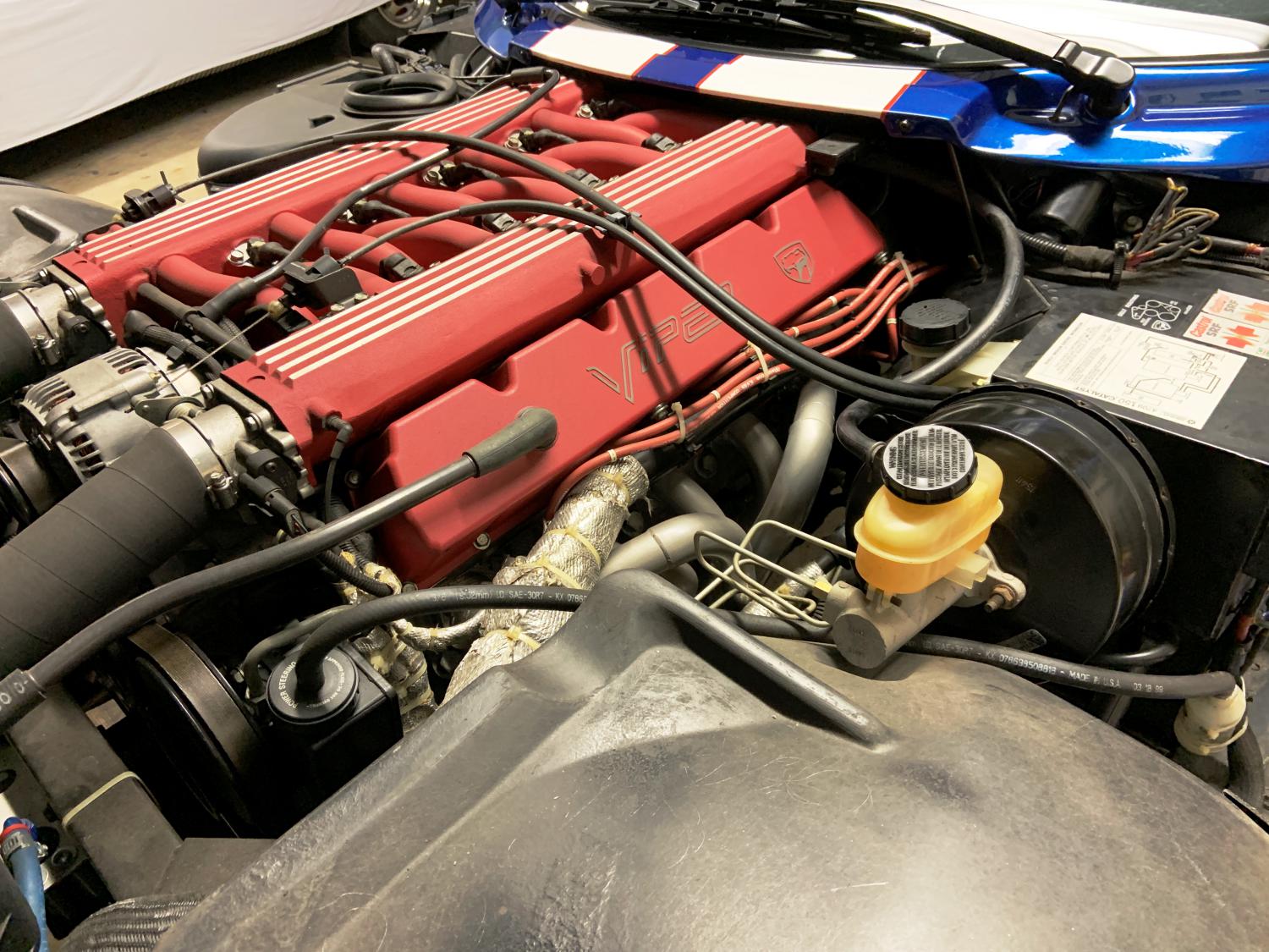

Then comes this morning when I was going to go and fill her up with 93 premium after siphoning out the old gas/Stabil mix. I went to push in the clutch and it felt very low and ineffective. And it wouldn't go in to gear with the car running.
So I did a little research and it is either one of two things: The clutch master cylinder on the firewall...or the throwout bearing slave cylinder in the bellhousing. One is a half hour job and the other is a 8 hour job.
I opened the master cylinder filler cap and it was empty of fluid inside. I added some and could see it took a while to fill so it must have gone somewhere. No puddles under car anywhere. I tried bleeding the system but it didn't get any better.
I ordered both parts from amazon and we will see in week which one it was. I'm doing the master cylinder first since it only took a few minutes to get it out of the car although I did have to grind down an old 5/8" open end wrench to make the tool to release the fluid coupling at the bellhousing.
I did perform an autopsy on the old clutch master cylinder and a lot of black liquid came out (versus the clear fluid that came out of the bellhousing bleeder screw.) So maybe it is just the master cylinder that pooped out. But you know how my luck goes.

The new clutch cylinder arrived yesterday from rockauto and I installed it today with a little help from the wife sitting in the driver's seat after she got home from work. YAY! That was the problem. So now I can return the throwout bearing slave assembly to amazon when it arrives.
And if you're wondering what that little plastic bottle zip-tied to the footwell-box near the clutch cylinder is, it's a homemade catch can for the power steering pump vent. Dodge in their infinite wisdom had a cap on top of the power steering pump that had a vented nipple pointing straight up. This made for interesting times when the car was driven in anger and the power steering fluid heated up, which then would geyser upwards and then onto the headers and left front brake assembly. So I just attached a length of fuel line and routed it to that catch can. Problem solved!
