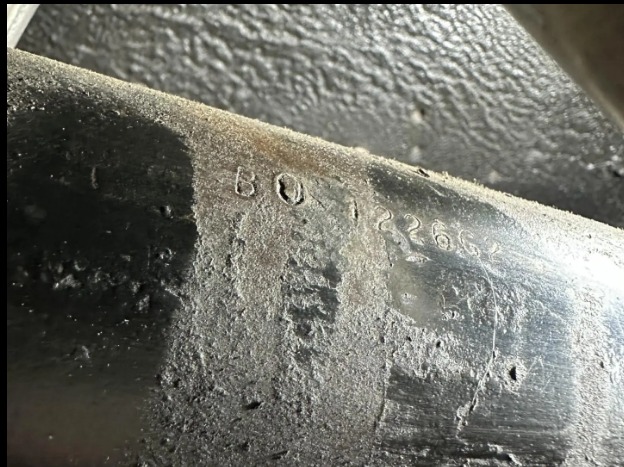

https://bringatrailer.com/listing/19...maro-z-28-184/
No mention of the non original drivetrain
Back in 2012 it was being asked about on camaros.net. Was bought as an original drivetrain car
https://www.camaros.net/threads/cowl...estion.208521/
Has a 388 block with casting date of K-16-8 and a rear is a BO1226G2
124379N609445

If the vin ends in 609445, wouldn't it be a March car?
Would the 02D tag be too early for the VIN. CRG says last car out in Feb. was 607164.
Educate me.
Partial vin stamp by the oil filter is not original.
November 16, 68 block assembled in Feb. 69? Pretty hard to swallow.
Block could have been swapped since BJ. No pic of the casting date in current listing.
Sits a little high in the back for a Z. Would like to see a pic of the rear springs from the side to see if it is four leaf.

VIN on block almost looks like something under it. There is a bare pad picture on the camaros.net thread and I don't like the stamp there either.
There is a 69 convertible on BAT now with the dash replaced and the seller seemed to think it was all original metal. Sites like this and the camaro sites are great to learn what to look for. Makes the subscription here well worth supporting
Educate me.

I read it. Sure looks like the same pad stamp.

That rear axle stamping looks altered also. The O in the BO stamping looks to be stamped over.
