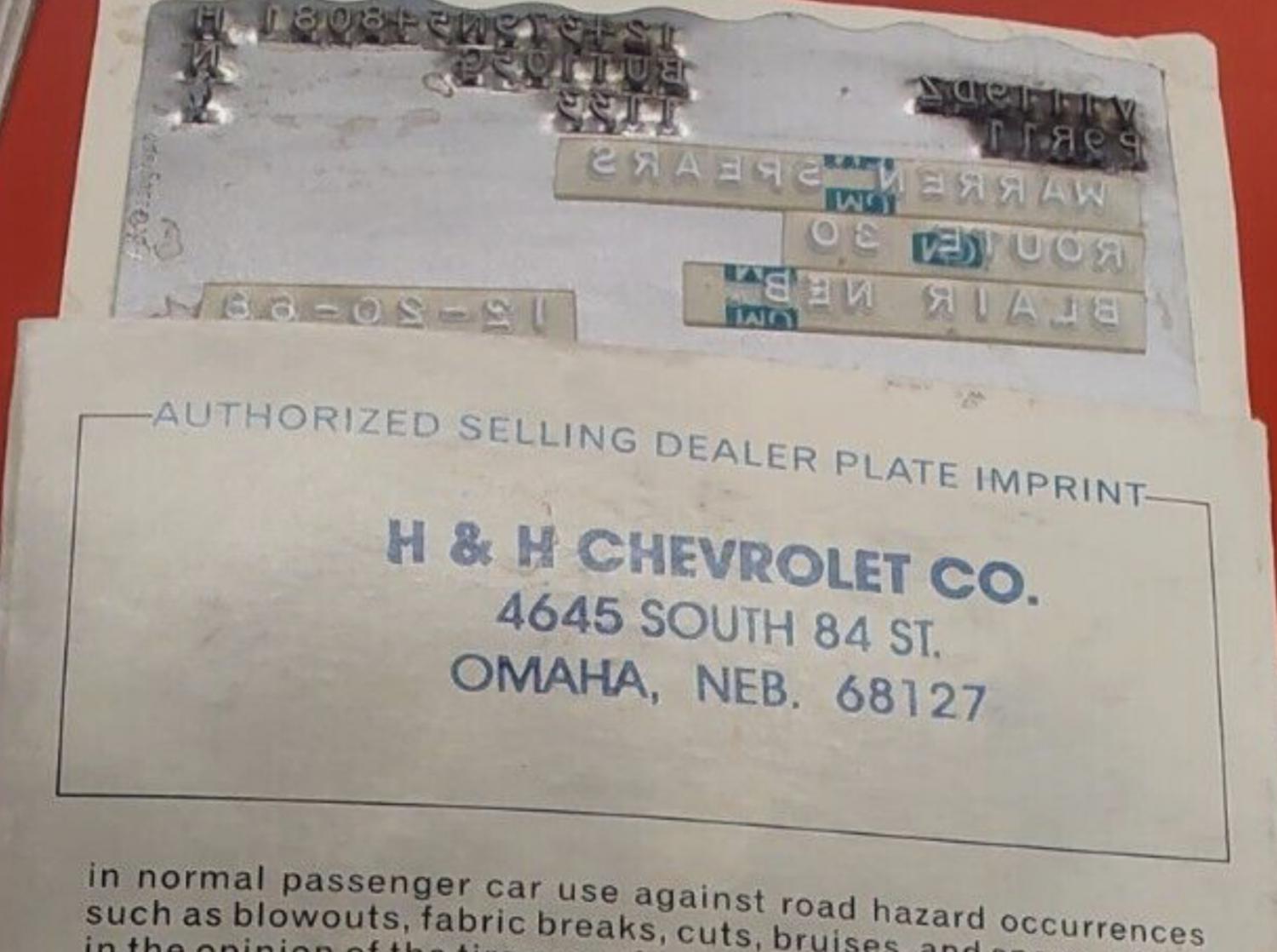

Here's a rare find, early original drivetrain M22 Z-28, rough but restorable and high asking price. I think you would be ok if you restored it yourself, but refreshing to see in a world of fake Z's. Maybe a member here will bring her back to full glory....

Some clumsy errors on the repro window sticker.
Makes me wonder about the rest of the 'docs'.

I see on the bill of sale the 3.73 posi was extra cost. I thought that was standard?

Standard Z/28 axle was a 3.73 open. Don't want positraction on a road course. Posi required with 3.73 ratio for other applications.
According to the docs, this was a customer order. Final-assembled on or about November 26, 1968, delivered December 20, 1968. Took 25 days to transport it 750 miles?

The trans stamp P 9 R11 C? (Oct 11). If so it would be to early to have the "C" at the end. Carb pictured is 924 (4th week February 1969).

Transmission is a restamp. As Danzo says, too early for C suffix which was a running change in late calendar year 1968. The POP doesn’t have a C on the transmission code. The partial VIN stamp on the transmission doesn’t match the pad stamp, easiest difference to spot is the numerals 1 and 4 which are entirely different fonts.
