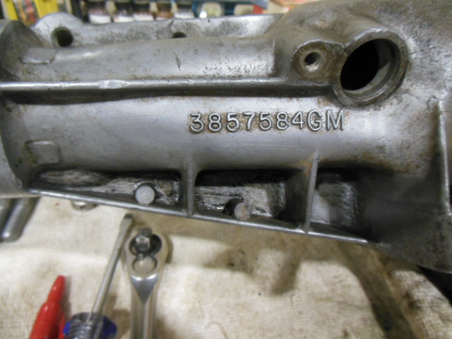

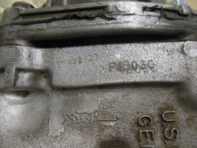

picked this up from a guy said it came out of hid big block nova years ago looks like a m 22 to me the numbers are double stamped P9B03C and the vin is 19W432890 does the stamping look correct

Definitely out of a Nova, has a W (Willow Run) in the VIN stamp, rare piece, looks like a legit double stamp to me, are those 22 "straighter cut" gears.? Experts can chime in

I'm no expert but would say yes to the straight cut M22 gear set.
