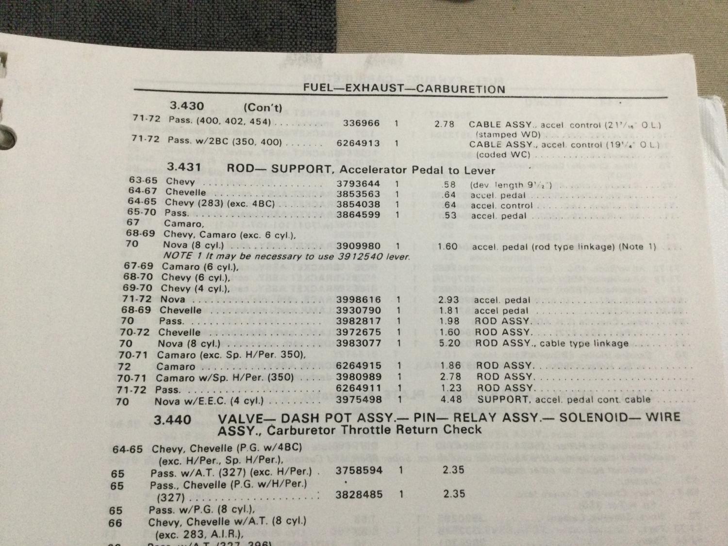

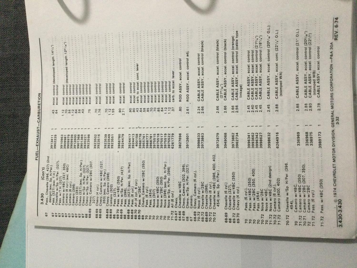

This should help.

Thx all. The last one I bought was the 3998642 (20 5/16" long). It's just a bit too long. Maybe the curved arm on the pedal is bent a bit? The first one I bought was a bit longer so maybe the 3996342 (21 3/8" long) but I can't find the old invoice. I'll have to find the cable and check it but it was quite a bit too long. The shorter one (3998627-18 /7/8" long) appears to be for a 2 bbl carb and would be too short, I think. Once we get the car out of winter hibernation, I'll check it out. Thx again, Oliver
