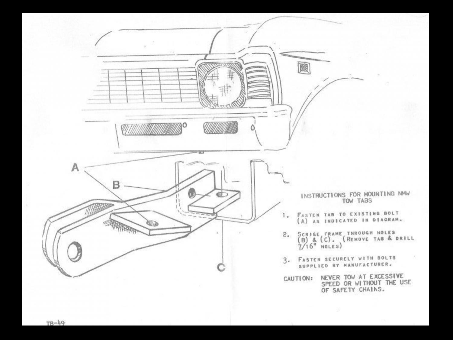

I have an original pair of NMW tow tabs. Trying to install them on a 70 Nova.
Are they supposed to be direct bolt? Can someone post instructions or better yet pics of them installed?
Thanks!

Here’s a couple past thread links that may help also NMW Instructions below as Member PxTx posted in the 2’nd one.
~ Pete
https://www.yenko.net/forum/showthread.php?t=116878
https://www.yenko.net/forum/showthread.php?t=129580

That’s exactly what I needed. Thank you!
