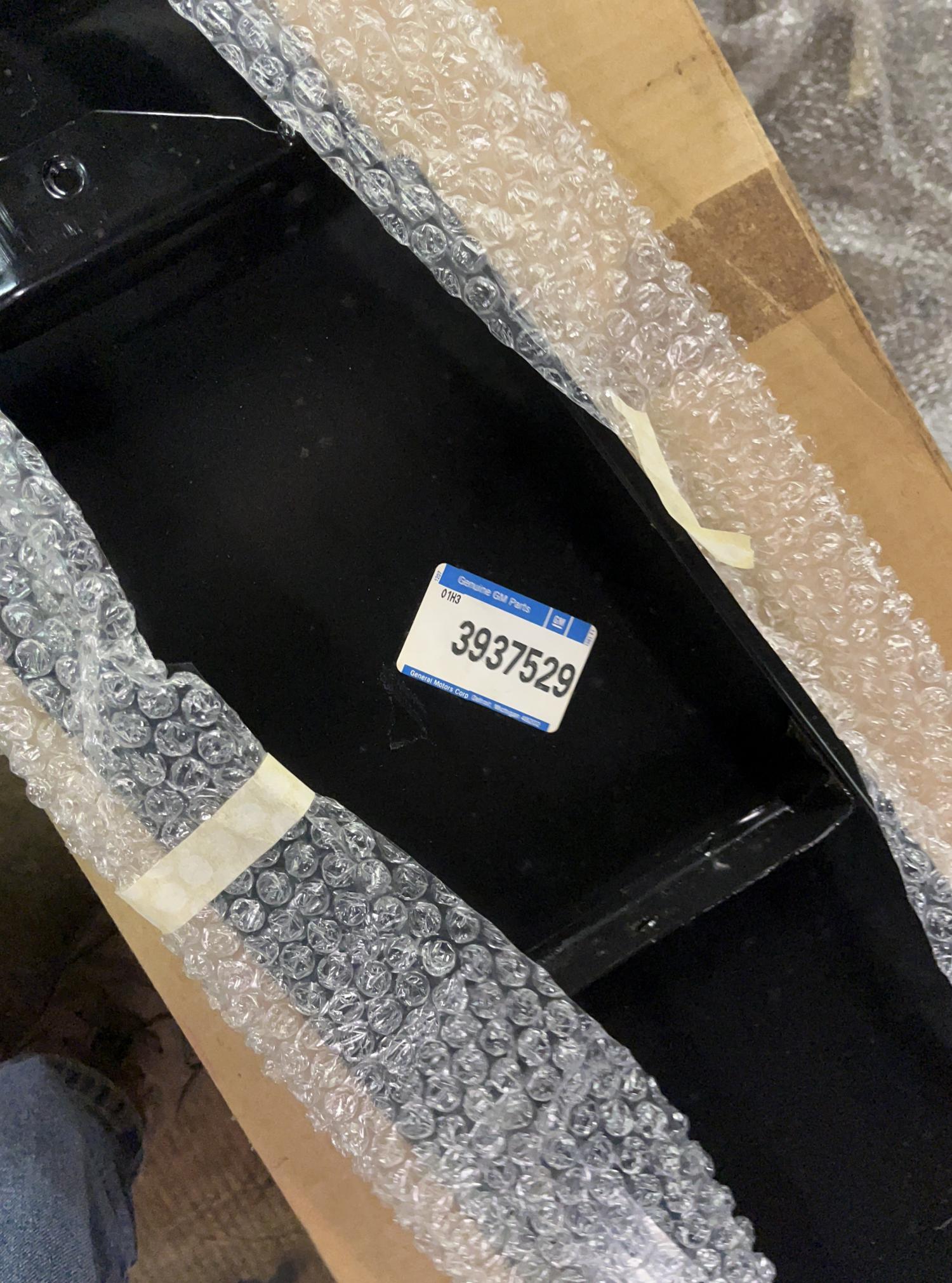

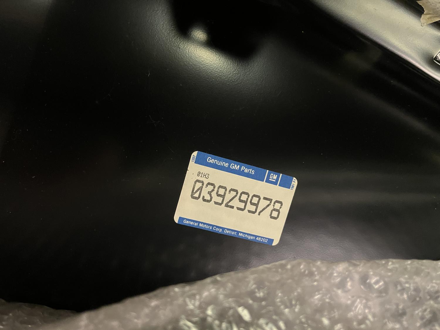

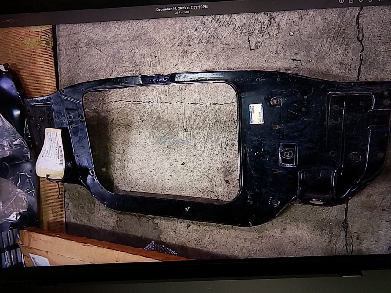

I have been buying NOS 69 Camaro parts for years and always vowed to never buy any NOS GM part with the later version barcode or with the (0) in front of the p/n. I know to always check the NOS quarter panels in the door jamb area to make sure all the impressions are pressed in because the molds are worn out.
I was contacted recently about a gentleman wanting to sell his NOS 69 Camaro parts, my question is for mainly the later version dated 8/17/92. Should I beware of any issues with fit or quality on the following parts. Also, is there a difference in value for the earlier version parts from the late 70's to mid 80's to the later 1988 thru the 90's later version?
Cowl Hood 03949708
Front Valance 03929978
Radiator Support 03962940
Door Skins
Front Std Fenders
Lower Fender Ext
Attachments - The Supercar Registry P2020006.jpeg P2020005.jpeg IMG_1981.jpg IMG_1977.jpg
No issues I was aware of, other that they don’t fit repro fenders/extensions well.
Heavy wrinkling along the top channel.
