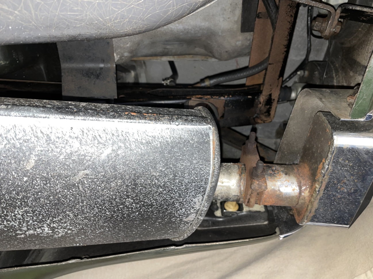

Here is one the tips from my 70 FWIW.....

Tips with part numbers stamped into them are service replacements, not originals.
The photo that NAPA68 posted is the correct one for 1970 ONLY. 1971 (give or take a few possible cars) and 1972 tips would also have a welded seam down the center of the bottom surface along with the welding around the rear perimeter. And no part numbers.

That makes sense that mine are service replacements. No rust. I know the car was painted (poorly) in 1984, then put in storage shortly thereafter. So, the PO likely put new tips on at that time.
