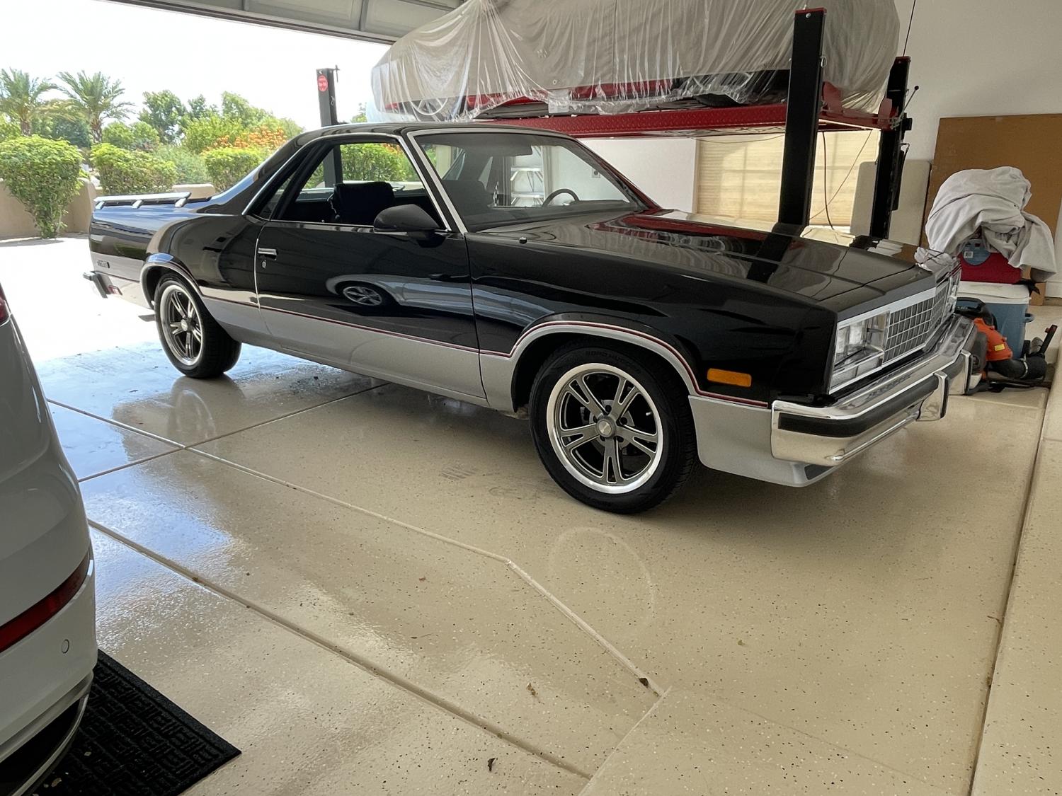

Default Brakes on my 87 El Camino
I have an original low mileage 87 el camino - 20K miles.
pads, rotors, and all the brake system is orig to the car. I feel like the brakes are spongey - like if i wanted to, I cannot LOCK them up if needed. It will stop, but to a slow roll, not lock up.
I bled the system and flushed out the fluid and installed new fluid. No real change - so im trying to figure out where the issue may be - booster, master, calipers and rear wheel cylinders need cleaned out and redone. Not sure best way to separate the diagnostics to pin point he issue, or am I at a trail and error?
Any advise? I have no leaks in the system, just a soft feel to the brake pressure.
thanks in advance.
