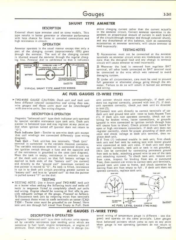

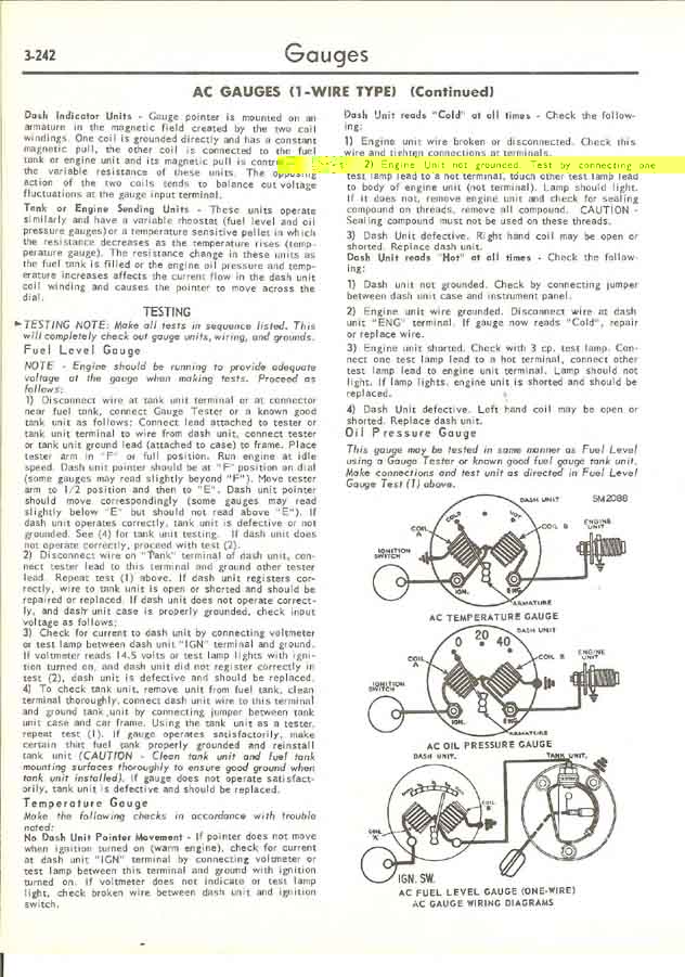

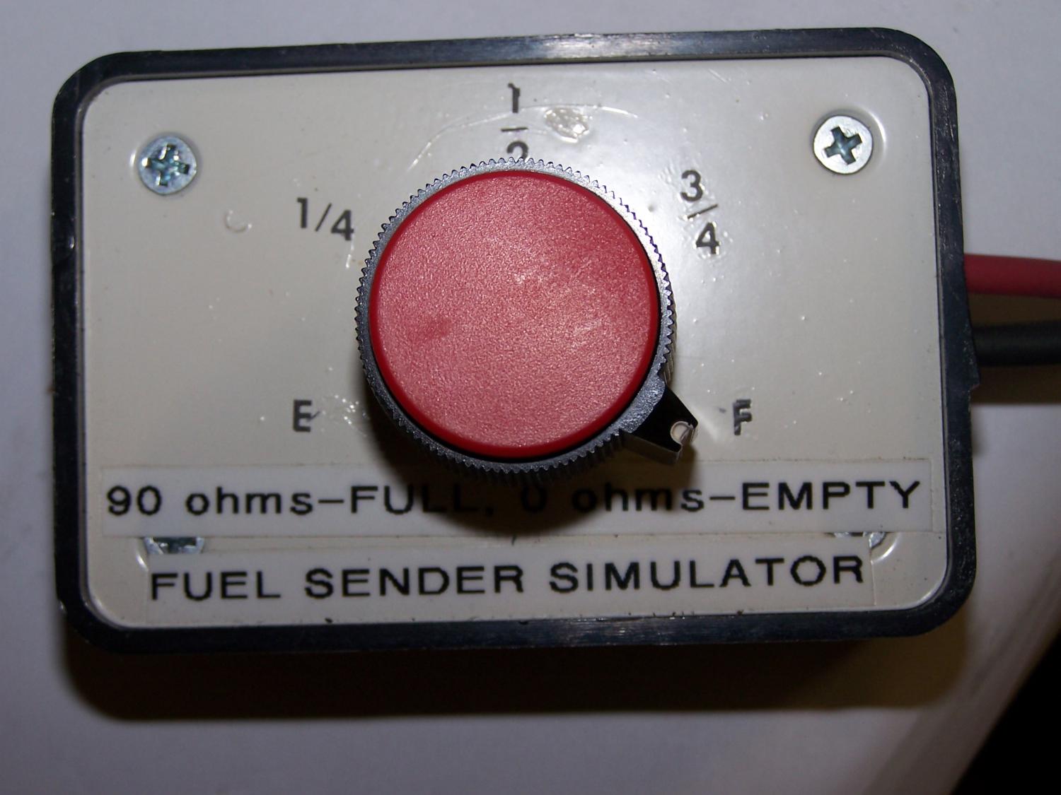

Attachments - The Supercar Registry Reference AC Delco Gauges_Page_2.jpg Reference AC Delco Gages_Page_1.jpg Console 41.jpg
