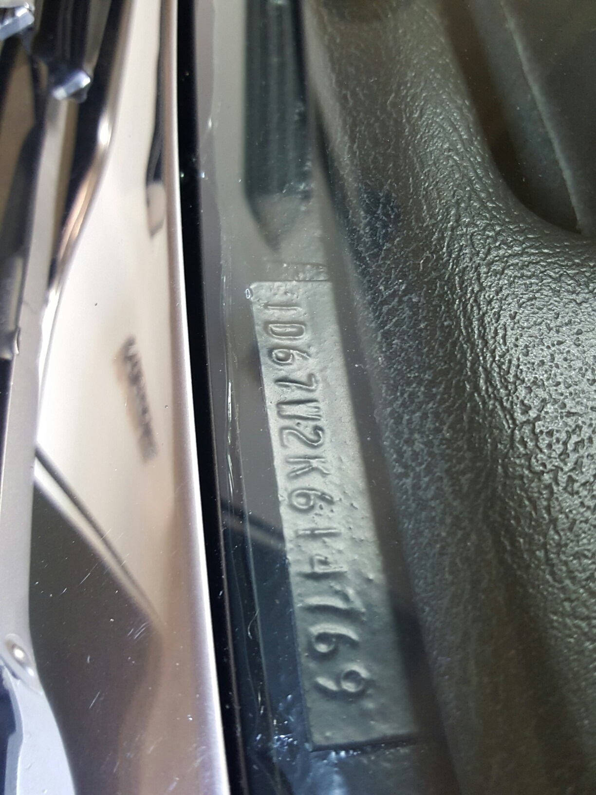

What is the correct valve cover for a 1972 SS 454 Chevelle? I thought they were painted but all the restorations I looked at had chrome covers? Also, would like to confirm that the oil fill caps were still the turn to hold style, not the push in style.

Painted with rubber push in oil cap.

Jake is correct. The valve covers for the 72 U and W codes are the same. They were painted with no decals. Oil plug was push in rubber.
Here are some pics of my old W Code vert.
Joseph Farrow
