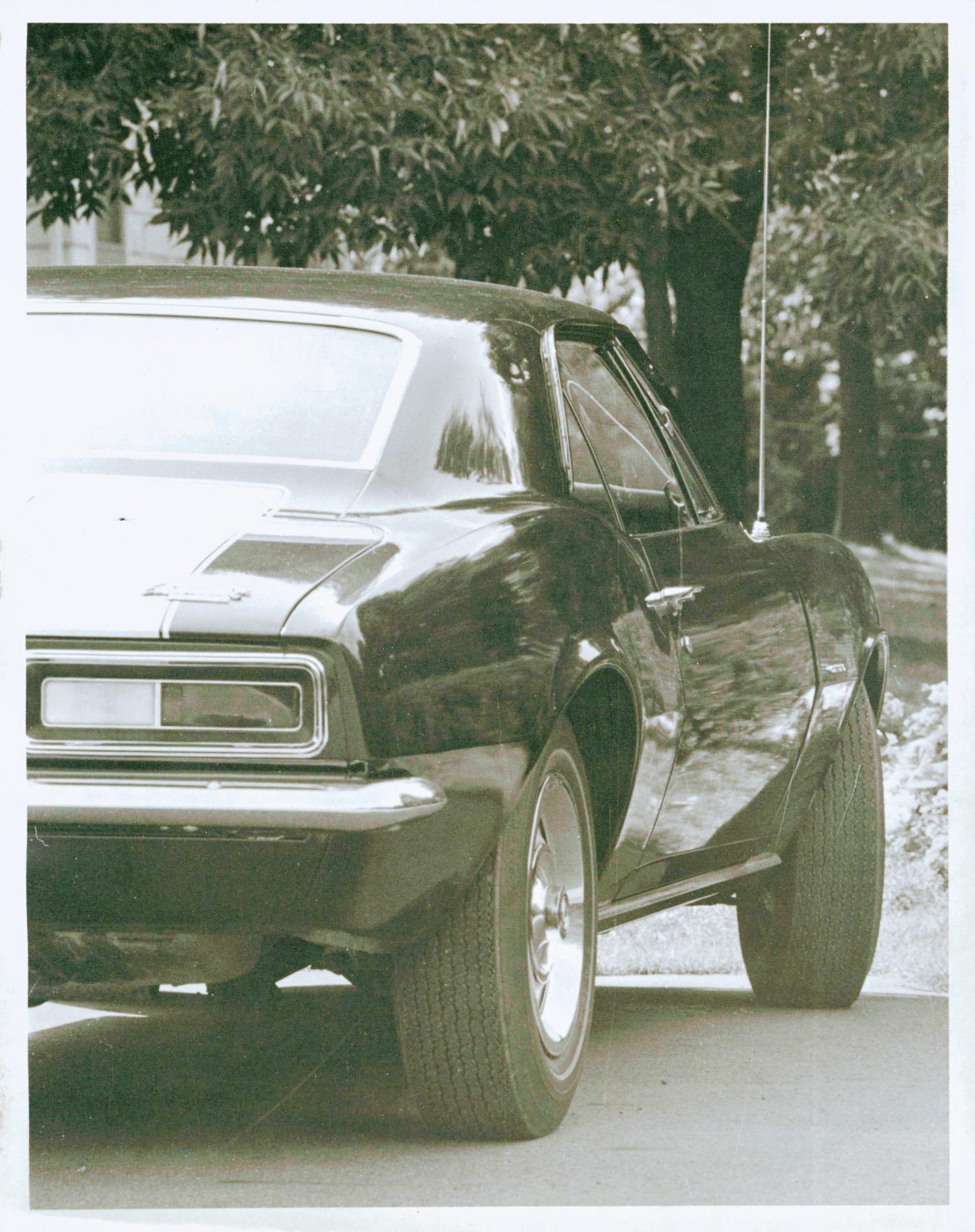

I'm getting closer to buying tires for my 67. I'm doing a light day 2 similar to what the original owner did. At first, I was going to pony-up the $600 a tire for the correct Power Cushions but I'm not crazy about the 'skinny' look. I then thought about the slightly larger Power Cushion for the 67 Corvette, but again I'm under-whelmed with the looks. I still want a redline tire so I started looking at the F70-15 Custom Wide Tread Polyglas. I think that might be a better looking and riding tire. Anyone else out there have any thoughts on tires for the Z?
The picture below from 67 looks like he may have already put on wider tires than stock.
Thanks
