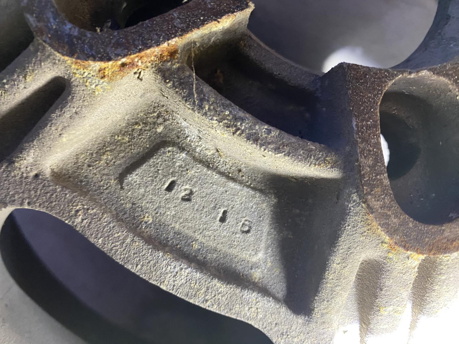

Here is the front rim off the car.

Clearly Ansen Sprint mags.
Is that a date code?
