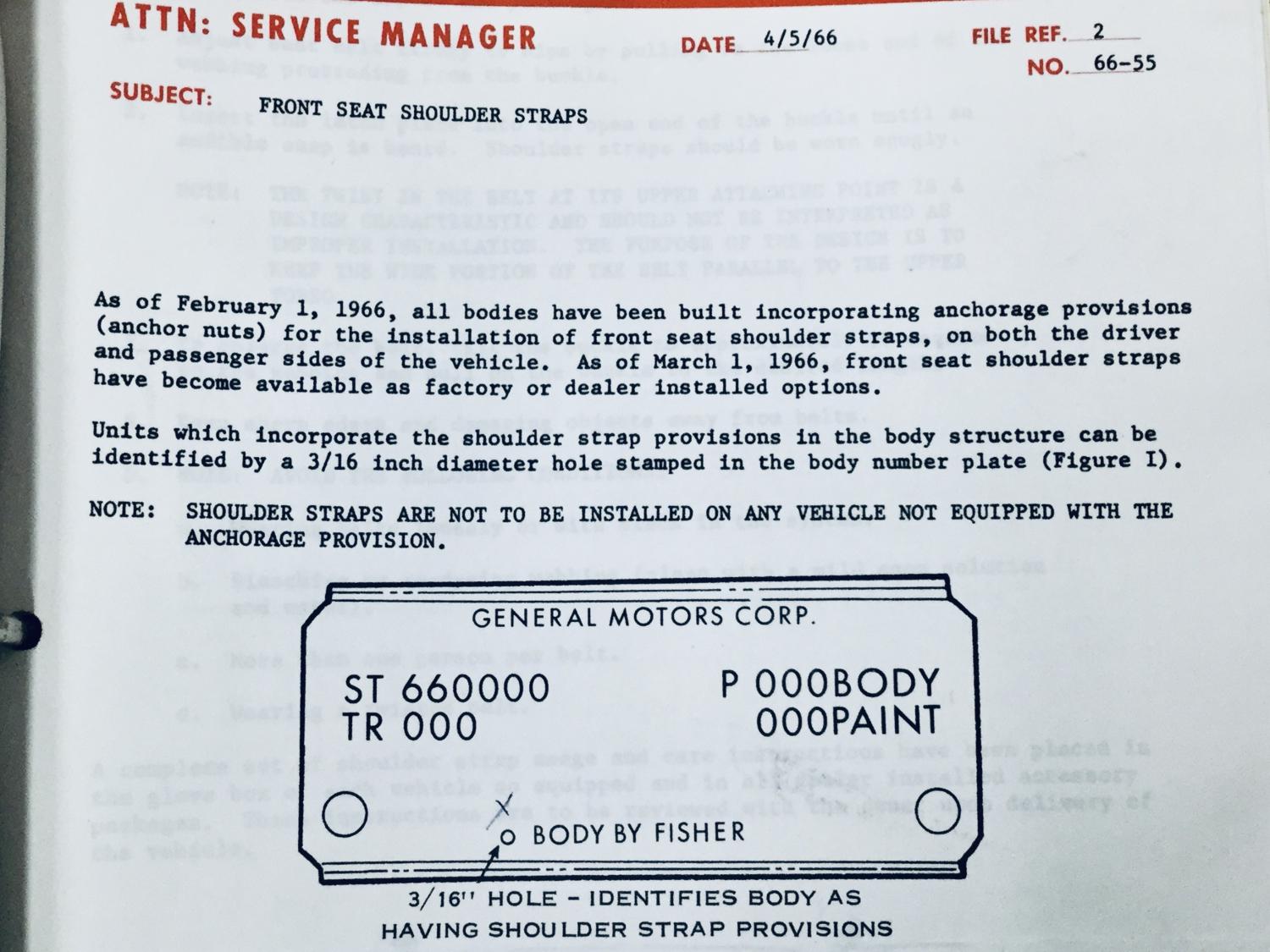

The 3/16’’ hole is on the 06D Data Plate as it should be.
