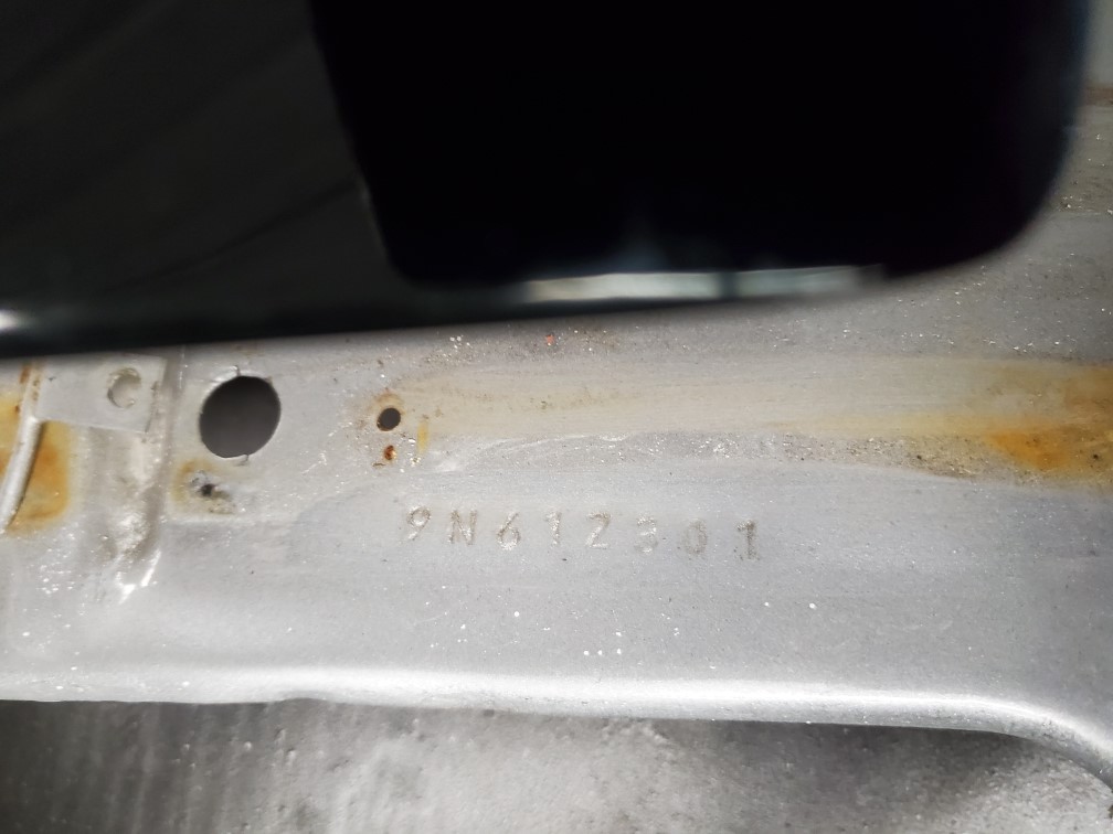

https://bringatrailer.com/listing/19...maro-z-28-132/
124379N612301
VIN tag only, sold on eBay September, 2001.

Engine pad looks like a bad restamp.
Can't tell if trim tag has been off. Has like 5 coats of paint on it.

I contacted the seller privately, so as to avoid the jackass drama queens.
He said it is appreciated. I advised him to check the hidden partial vin under the cowl panel. It may be puttied in. Most of the time the guys selling a car like this have no clue about the shady past.

I noticed the dash has been replaced, maybe the cowl has also.

Default Partial vin on cowl
Partial stamp on the cowl.

The more I look at it, the less I like it.
