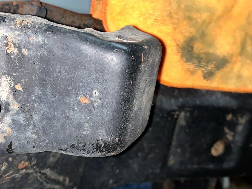

I have a 67 and 68 Z28 with the same style Engine Frame Mounts or Stands
(The ones that bolt to the Subframe).
They are definitely original to the cars and don't have any part numbers stamped on them. They also don't have the reinforcement on the bottom, where the bolts goes through.
I have acquired a pair of NOS #3955183(L) and 3980938(R) with the part # stamped on them and they both have the reinforcement bracket. These are supposed to be the correct part numbers being documented by David Pozzi Racing Suspension.
However, CRG indicates as the correct # 3892733, 3892734. I wonder if mine are these??
My question is should the leave the born with or replace with the NOS, which are considered correct and or the norm. I don't want to have point reductions when I get the car judged.
Thanxs Dave
