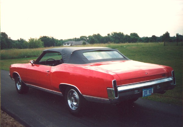

A friend of mine built this SS454 convertible in the mid 80's grafting all the Monte panels onto a GM a body convertible and reworking the quarter panels, recovering the rear seat and side panels with Monte Carlo upholstery. It sported a real LS6 engine and Turbo 400 and have a steel working cowl hood. Pretty neat car for its time.

Interesting. The photo of the Red convert was built by Bruce Haar from Bloomington, MN.

Did he extend the wheelbase on the A-body donor car or shorten the Monte Carlo's front clip??

I do not recall exactly how he did it but I know he used a convertible frame and the Monte front frame section. There were no body modifications from stock other than the hood and quarters being modified.

My thought would be cutting off the roof. Installing the top rack.. windshield frame and 1/4 windows. I have never seen a MC convertible conversion in person.. only pictures. A guy might need the A-body tub structure to make it turn out right.

I should have clarified better, Bruce used an A body convertible donor and grafted all the Monte sheet metal to it so he made use of the windshield frame and all the other convertible structural items.
