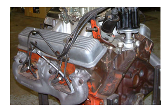

Here's a factory painted engine. This factory worker might've been a little lazy this day...Joe

----Bugsy, It's really not all that uncommon for there to be no paint in a lot of areas of the engine. Ask anyone with a true original.....Bill S
