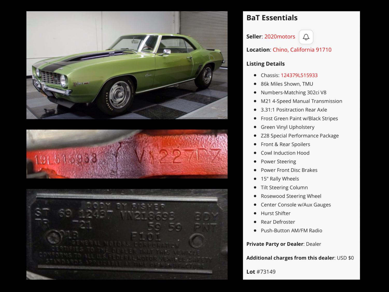

Looks like a decent Van Nuys car with born with drivetrain and POP.
Looks like an older restoration. Missing the headrests on the seats.
Stampings of drivetrain all look good.

Factory M21/3.31 posi 12 bolt car. High speed tourer-no stoplight bandit

Are other examples in close range known w/ same stamping irregularities?

That engine stamping is legit. I have 3 other legit stampings with same date. One is an LA car made within 400 cars of this one

Is this a crack in the pad? Never seen that before. Casting flaw issue?
