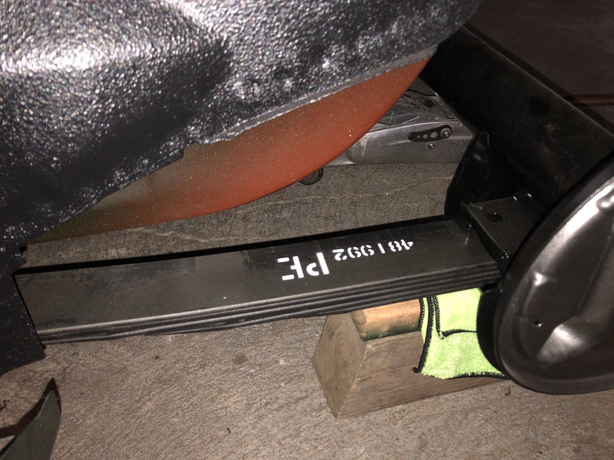

What the best product/method to duplicate the factory undercoating in the wheel wells?
Attachments - The Supercar Registry CTZ Leaf Spring.jpg 100_1867.jpg 100_1866.jpg

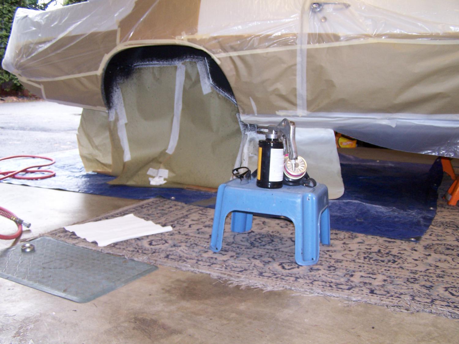

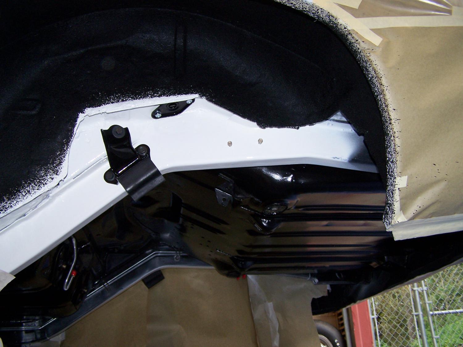

Default 3M product and applicator gun RESULTS
This was my amateur attempt on my Driver Z11 (LOS)
Using the above 3M product and "gun"
Frame on underbody Fluff.
