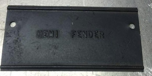

Maybe that was the start of ‘Hemi fender’ fender tags.

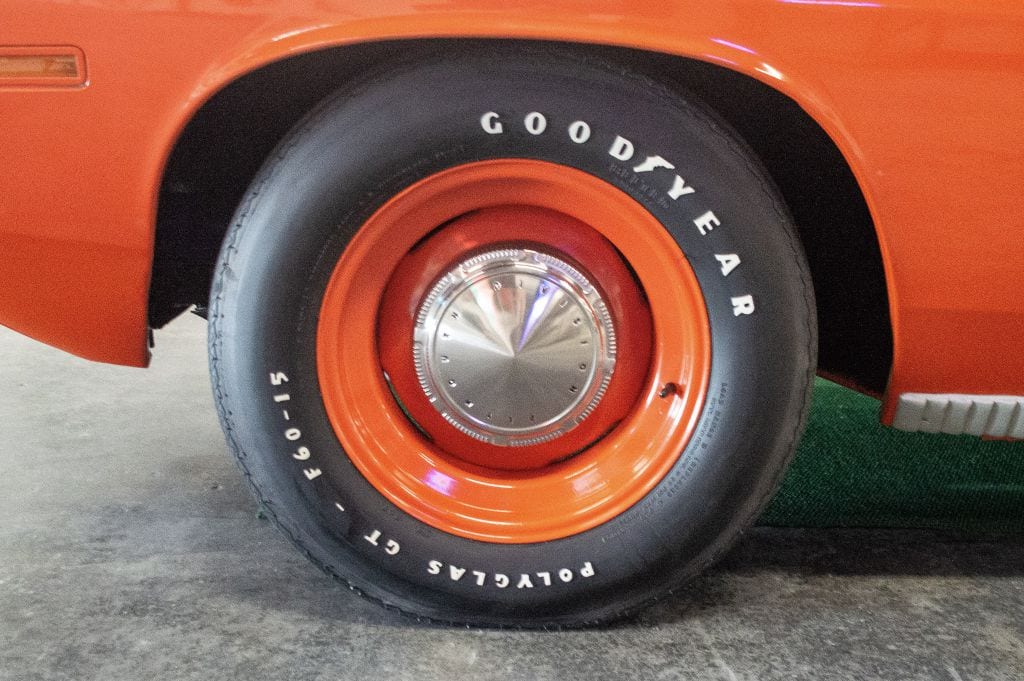

Correct Charley, the 15 inch rally wheels and F-60-15 tires on 1970 Hemi E-bodies required a clearanced fender, wheel lips rolled back etc. Assembly line folk probably put the wrong fenders on in Hamtramck (this car may have been part of the learning for that).
Hemis came standard with 15s. Six-Pack and others ordered with 15-inchers as an option got E-60s.
As to why it had to go to an offsite body shop... dunno

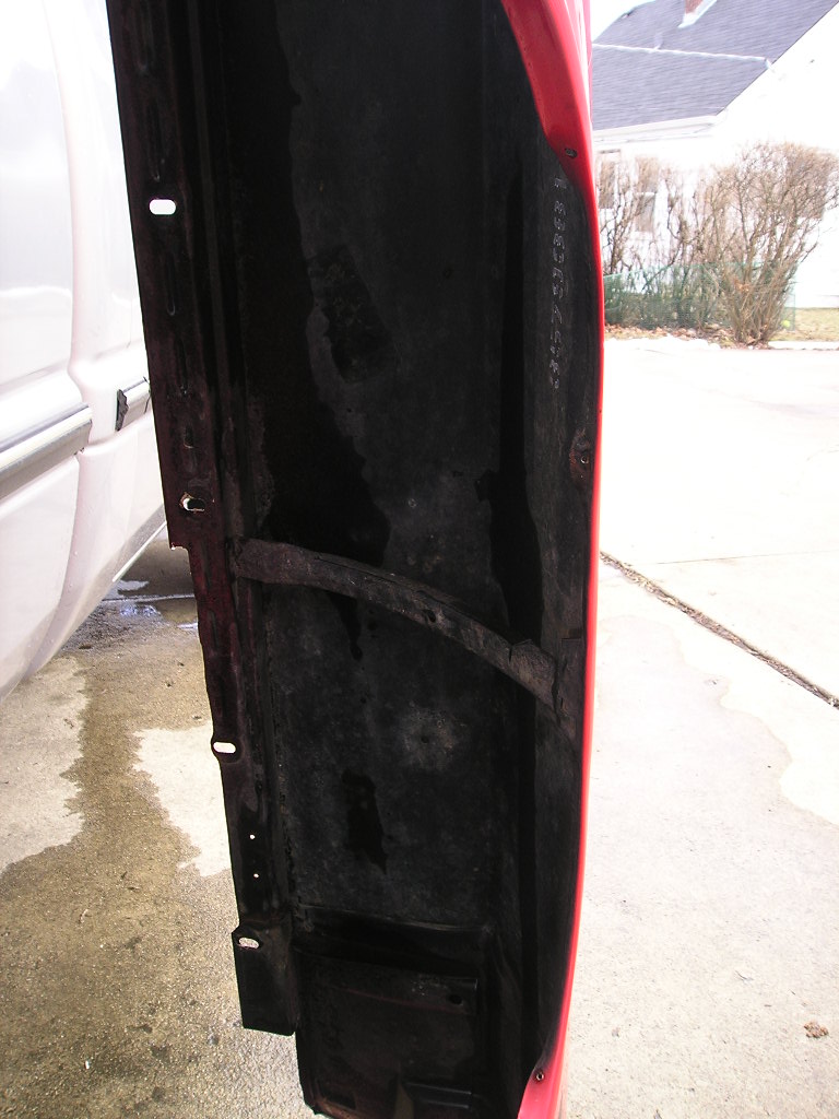

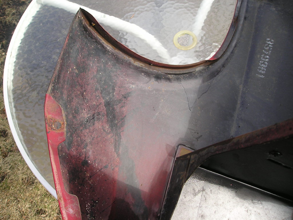

Rolled fender

It was pretty crude

Very interesting. The write up says it came with plain steel wheels and dog-dishes. No wheel or tire related options are shown on the report that is pictured. So would that combo still have had a clearance problem?
