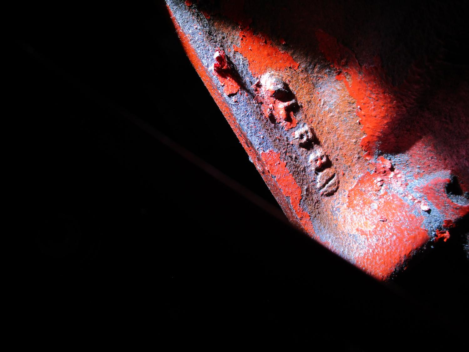

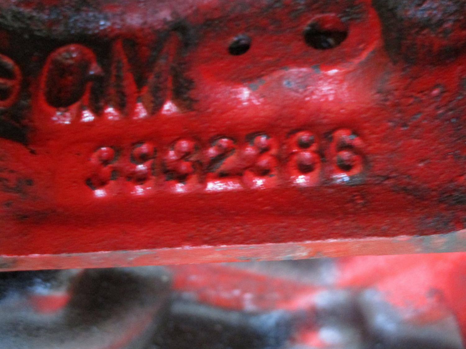

Hello all, I'm a new member...need some help.
Wasn't sure if I should start a new thread or just use this one I found during a search....
I am in similar situation to the OP. I have a 1969 clone and pulled the DZ302 (I believe the engine is a true DZ, but the car definitely is NOT) last year and put a 383 crate engine in. Very happy with the result, but now wanting to sell the DZ engine. The DZ is not all original parts...aluminum aftermarket heads, aftermarket intake, aftermarket carb...etc. I think all the short block parts are true DZ though.
So I first want to understand my engine codes, hoping you guys can help
Casting # 3932386
Date code is tricky...I thought they had to be four characters...but mine appears to be three... L68. Could that mean December 6th, 1968? Or if the day was single digit should it have a zero? In other words, would December 6th 1968 be L068 versus L68?
I have not yet seen a VIN stamp anywhere...but I need to look harder by the oil filter. The engine is in a wooden crate and hard to get to...so it may take me weeks to get around to this work.
Ok, so if it is a real DZ short block, what would be a good market value? I'd prefer to sell the engine whole...don't want to do all the disassembly work. It's bored .030 over and the only flaw I've found is that one of the cylinder head bolt holes has been helicoiled. I had the engine in my car for many years, and it ran fine...so I know there's no issue as far as it holding up...but the engine was last rebuilt before I bought it in 1983 so it needs refreshed for sure.
Where would be the best place to advertise it? How expensive would shipping be (I realize it depends on how far...but are we talking a few hundred?) and what's the best way to handle that as far as which company to use to ship? Would You build a wood crate? I have a huge crate that the whole engine is in...would take a fork lift or something to get it in a truck though....if I end up disassembling and selling just the short block I could use a much smaller crate.
I'll try to attach a few photos, thanks for your help!
Dave

Stamping is legit. Most likely out of a Norwood car if the VIN is not stamped on the pad. Casting date of L 6 8 translates to Dec 6, 1968
Partial VIN will be down in the rough casting on the side of the block by the oil filter.
Take a look and see what you got

Thank you. I need to get a better picture of that date code, may be a 5 and not a 6. It may take me a few weeks to get around to this...it's tucked away in a crate.
