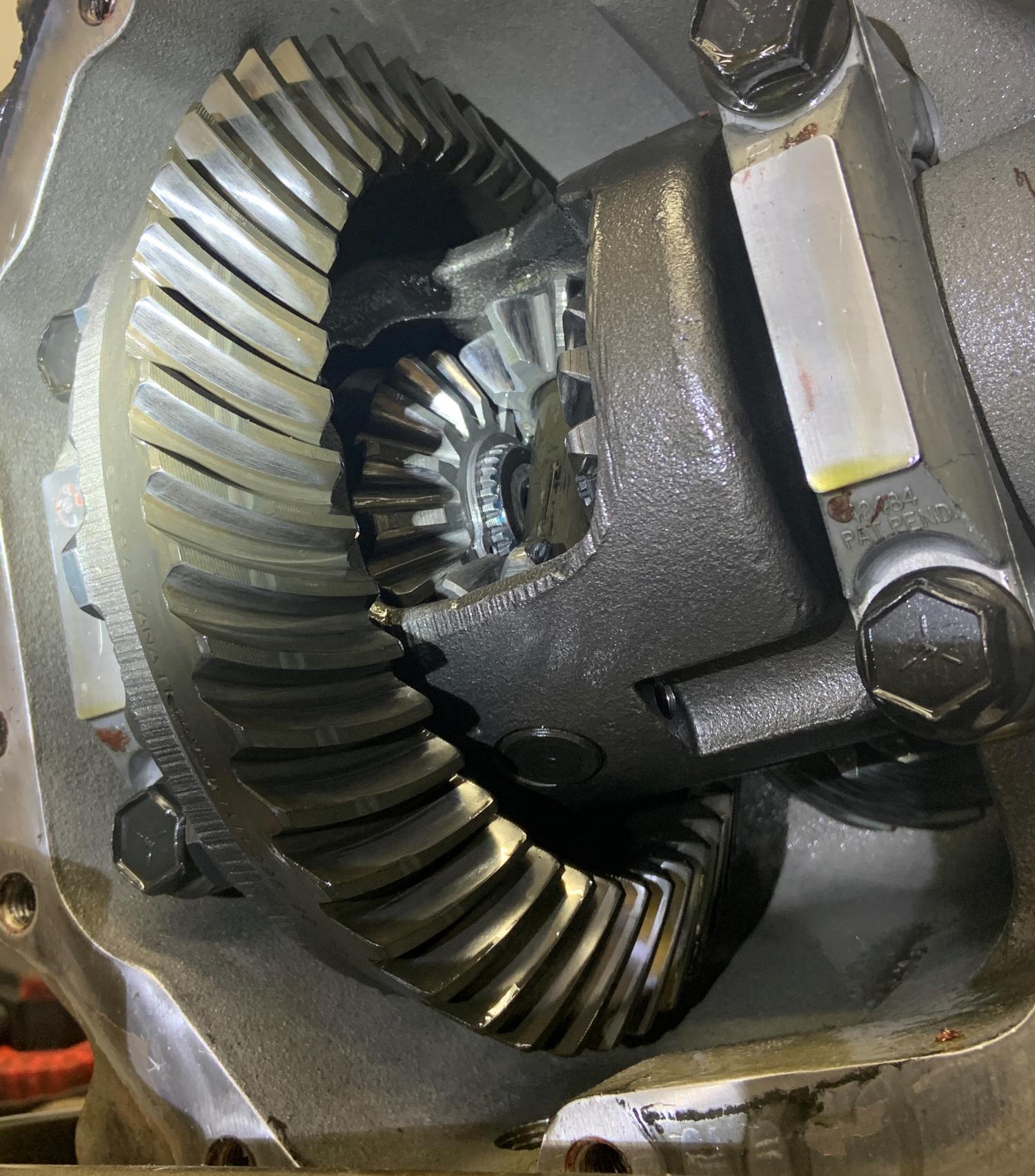

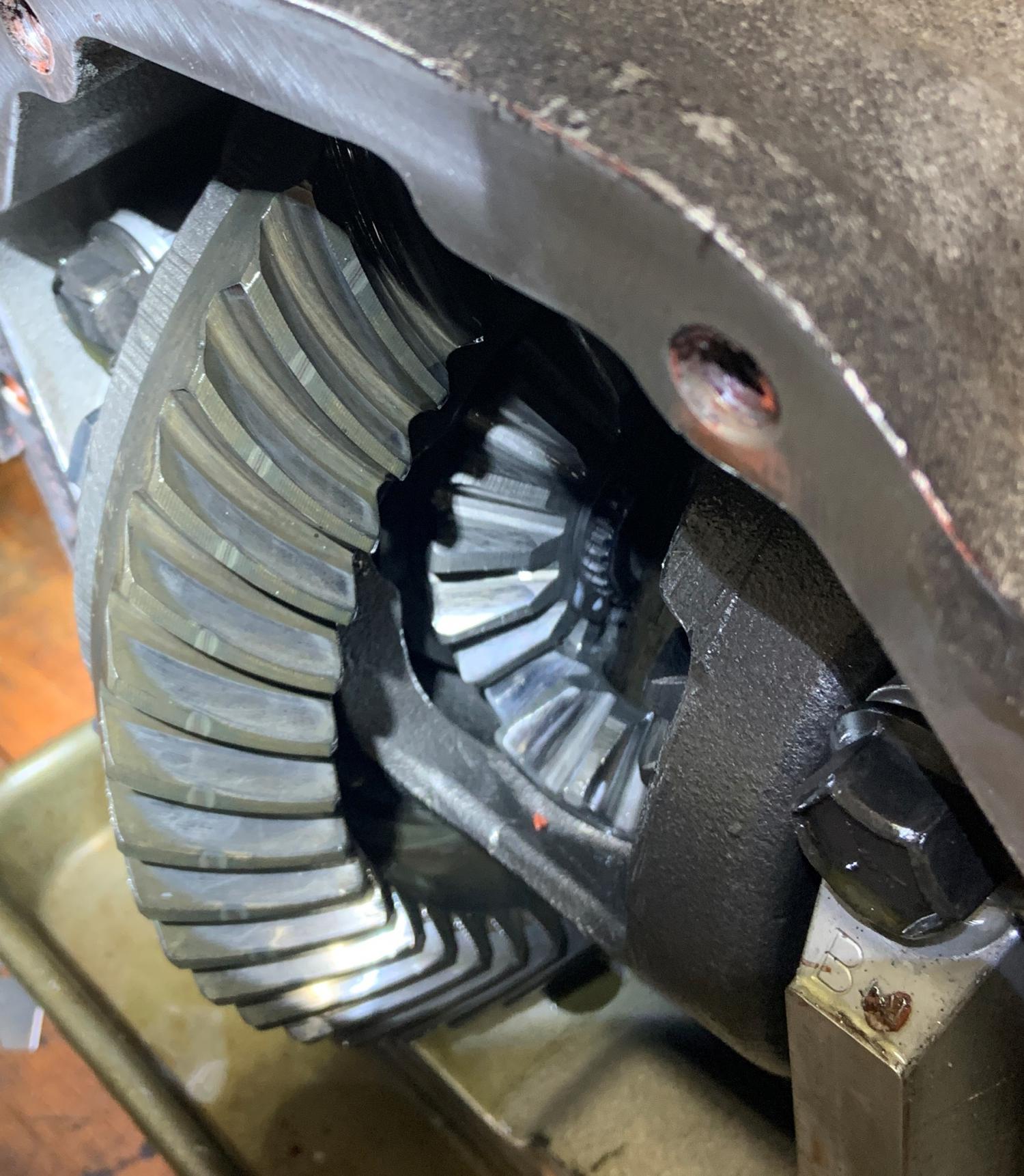

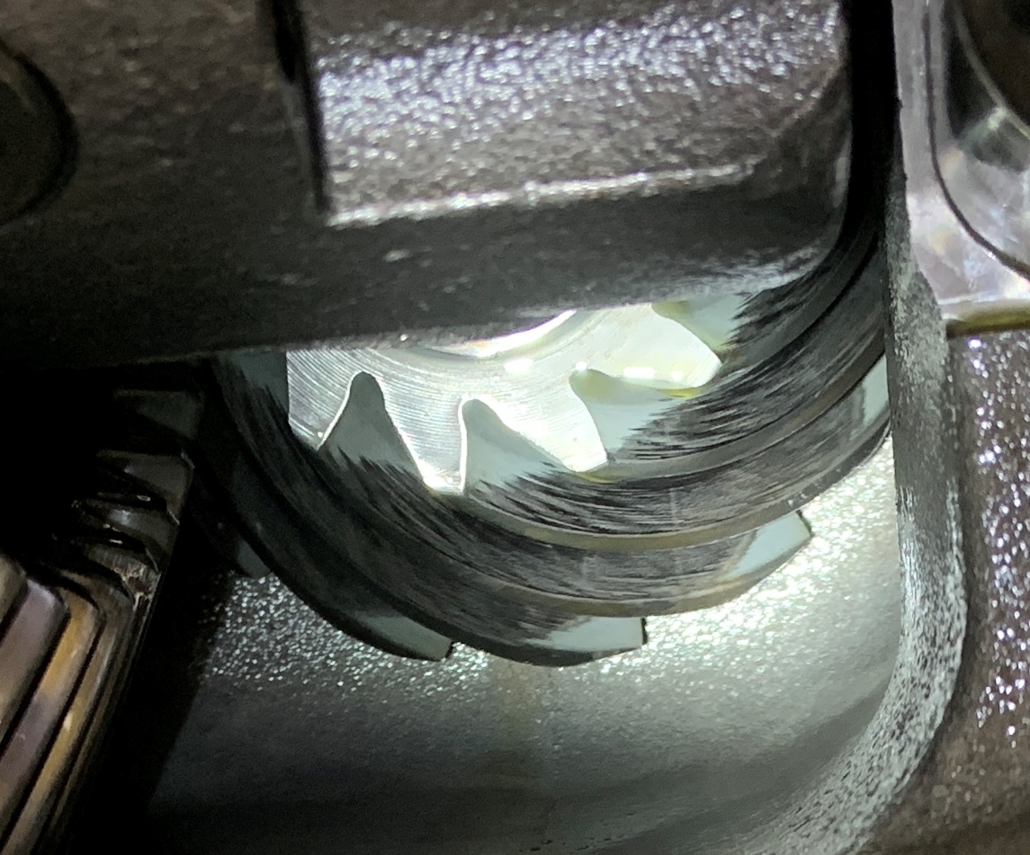

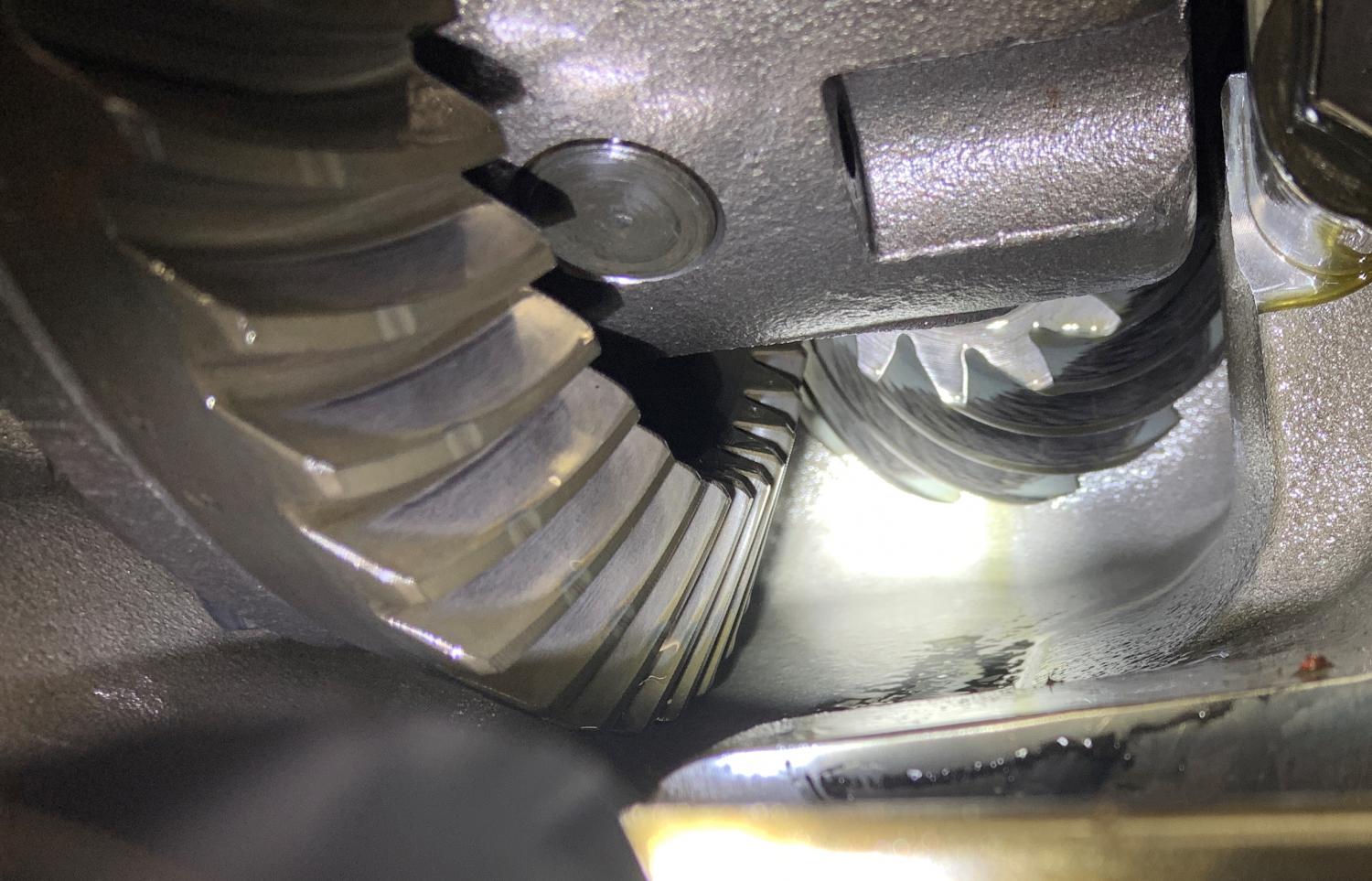

This is the gear set in my 93 viper's Dana 44.
If you go here it gives all the details: https://www.yenko.net/forum/showthre...76#post1604576
Basically, there was 200X the amount of iron in the fluid than should have been there indicating something getting chewed up. There is what sounds like a bearing cage issue in the pinion bearing - I can hear a "tinkling" like a loose roller in a broken cage.
What do you think of this pattern?
Attachments - The Supercar Registry pattern 4.JPG pattern 3.jpg pattern 2.jpg pattern 1.jpg
Old 11-05-2022, 06:40 AM
big gear head's Avatar
Join Date: Mar 2012
Location: KY
Posts: 3,431
Thanks: 5,958
Thanked 1,570 Times in 793 Posts
Looks like the pinion was just a little too deep to me.
