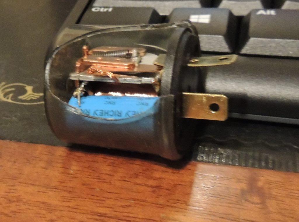

Looked at the wiring diagram last night and was reminded that the pink wire from the fuse block goes directly to the TS flasher. I haven't worked on 60s wiring in forever.
Remembered that there was s cheap aftermarket flasher installed before I got the car. I saw it when I was putting in the air shock fill lines on the jack pack.
Looked under the dash this evening and sure enough, it had broken, come loose from the holder and was laying on the bottom of the dash frame. I had to pull it off. It was essentially welded on to the dash frame.
Put in a 53 year old flasher I removed from a 69 Camaro. All is good.
