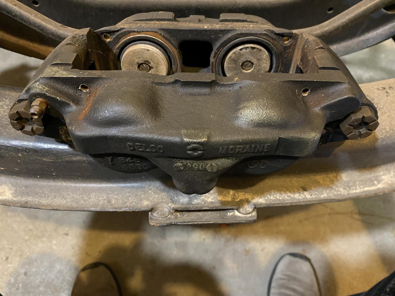

On the 1968 Camaros with the J-56 opition were the calipers Dual pin or Single pin from the factory?????

Four piston Caliper with single pin retention.

IIRC, Corvette was the only GM car I can remember that had dual pin pad retaining calipers and that was on the J-56 Heavy Duty brake system required on the L-88's and ZL-1's
Bill
----Huge cotter pins to be exact.....Bill S
Yes, I do remember that Bill, and also a story about a guy taking his calipers in to be rebuilt on a a Corvette he bought and they had dual cotter pins. The shop he took them to said to drop the fuel tank and see if it said L-88 on the tank sticker, and Walla! Another L-88 Found!

And folded over brake pad tops so the pads would not warp when hot.

There was no J56 option for 68 Camaros, just J52 power discs.

My 67 Z came with J56. The original owner modified the calipers per the factory drawing to the dual cotter pin design.
