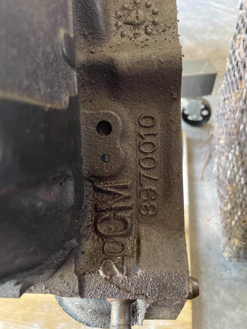

I sold the DZ block that was in my old Camaro to a fellow member, who was able to pull up the serial numbers by the oil filter, which were 19N6 4527.
What do these numbers match, the VIN of a 1969 Z?
Is there any information we can glean from these?

Yes, thats the partial VIN
124379N6x4527 would be the full VIN
What was the stamping on the pad? That could maybe narrow down the VIN possibilities

Thanks Jonesy. The block was decked, so the DZ and the rest on the pad could not be read, unfortunately.

Inserting 0-9 into that VIN would make it land into Feb twice, March once, April once, May once, June twice, August once and Sept twice.
What's the casting date?

Do you have a pad stamp picture Mark?

It's a 39700010 block, and the pad was blank. I used acid from a couple different forensic kits to try to raise it, but nothing showed. Guess it was just cut too far down or the OG stamp wasn't very deep.
