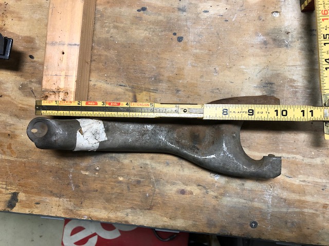

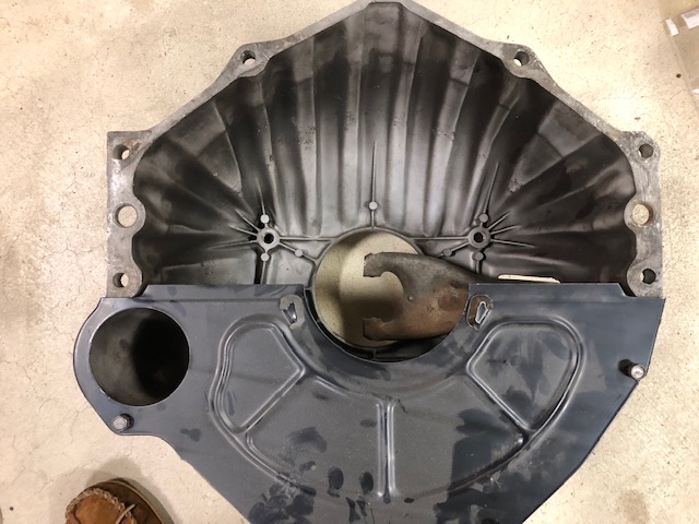

I went down and looked at my 621 bellhousing and fork destined for my 69 SS350 and measured the fork (no numbers on it ) and it measures 10 1/8". When looking down the center it does look aligned, but I hope it is the correct one! I bought it many decades ago!

Thanks, did you fully seat the fork on the ball stud for this picture?
Yes it is.

Thanks for the clarity fellows. Per your post and the pictures above I re-checked mine and it fits just as in the posted pics. I simply had it seated too deeply in the fork opening, not riding on the end of the fingers. My learning experience. Regards
