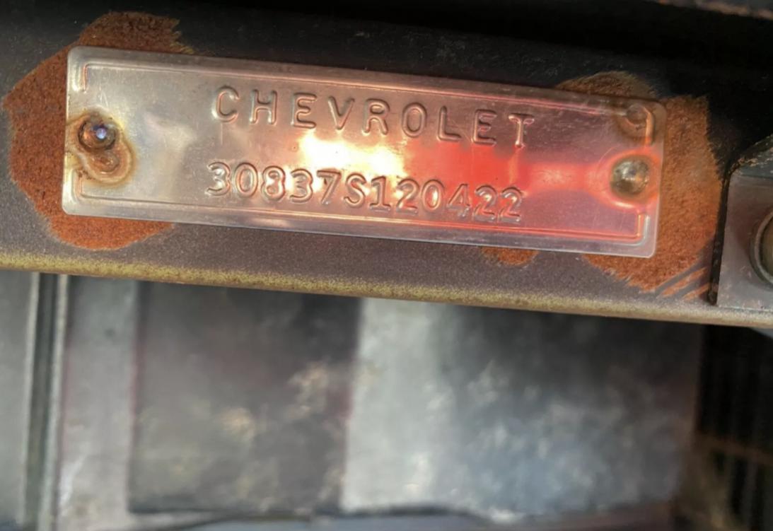

What’s with the rust around the VIN tag rivet locations?

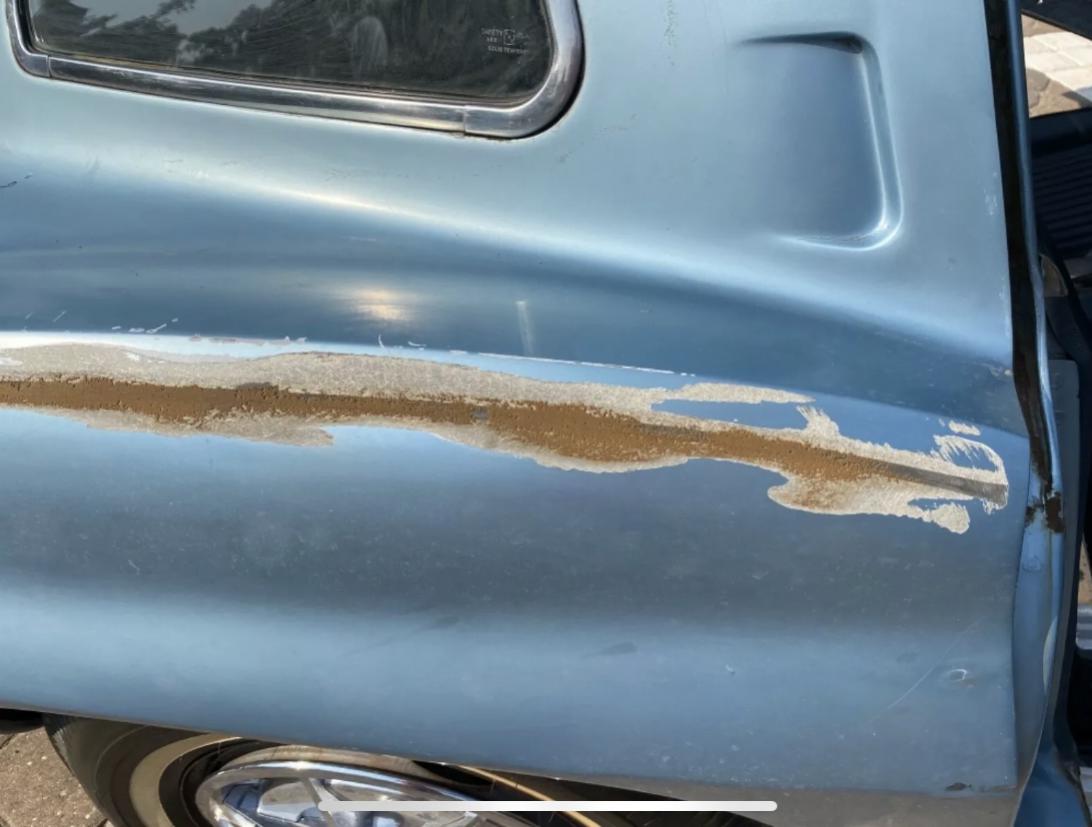

Could that that rub-through on the quarter be from being tarped?

The rust around the VIN tag is just flash rust. They ground the birdcage before spot welding the tag when produced
I'm thinking someone started to work on the body seams for whatever reason. It's a car that deserves a closer look considering the hysteria revolving around SWC's right now.

Looks like a great body, and the tags are definitely original. Lots to like here except the 250hp base engine that should never have been offered in a Corvette (also personal bias).

----RD is a 327/300hp engine. It's sad that the owner (I guess) sanded down those areas as this car would do well as a survivor with a basic clean up and a few repairs.....Bill S
