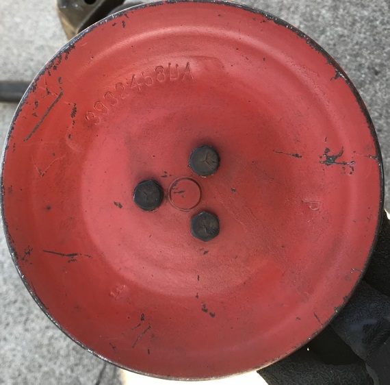

I've had two recently; photos here FYI:
https://www.yenko.net/forum/showthread.php?t=153641
and
https://www.yenko.net/forum/showthread.php?t=161824
Cheers,
Anthony

Originally Posted by AnthonyS View Post
Thanks Anthony just want to make sure, looking at your Orange one the fonts look like mine but the other one there are no splits in the top of some numbers.

Yep, maybe compare with a known repop pulley and check the "9" digit...
The original stamping anomalies (splits) are known and I'm (I'd be) surprised that the reproduction companies are picking up on that... but confirm that 9 maybe with someone else as I'm no expert on these but that nine's tail looks different to me, just my opinion and worth what you paid for it.

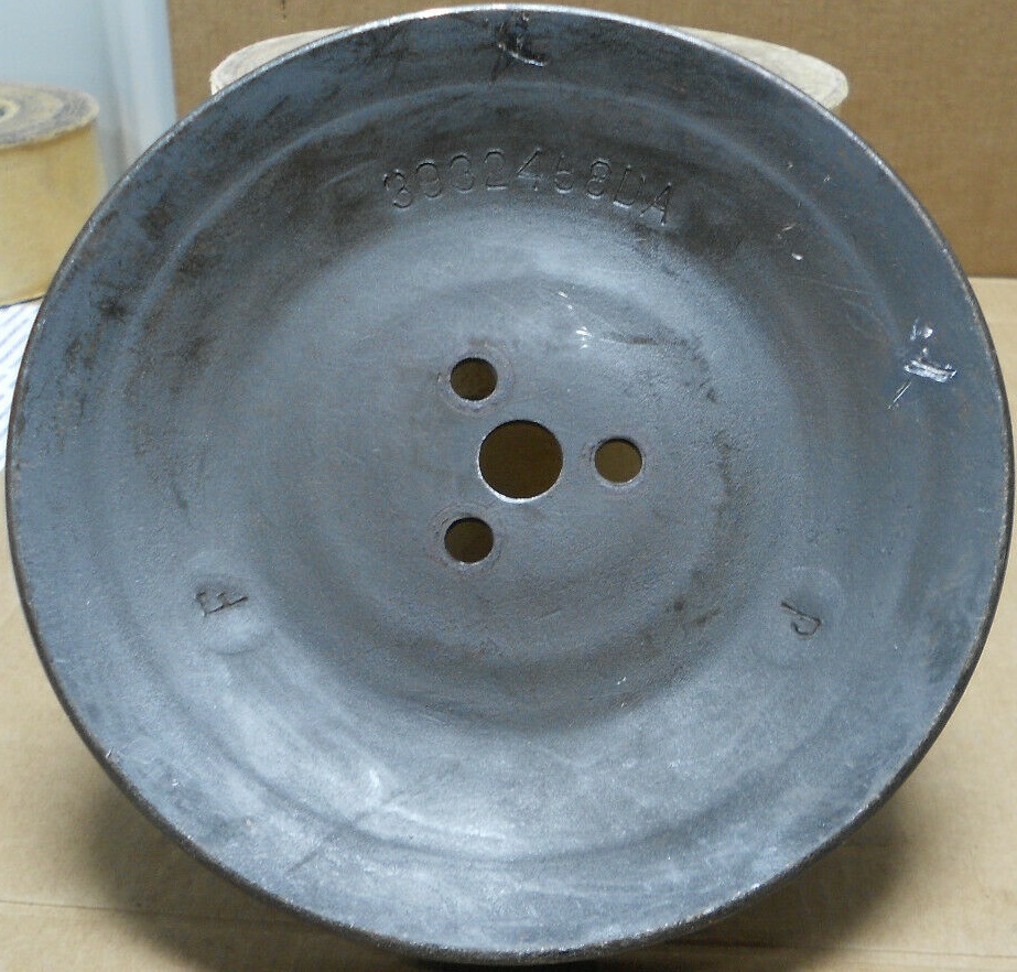

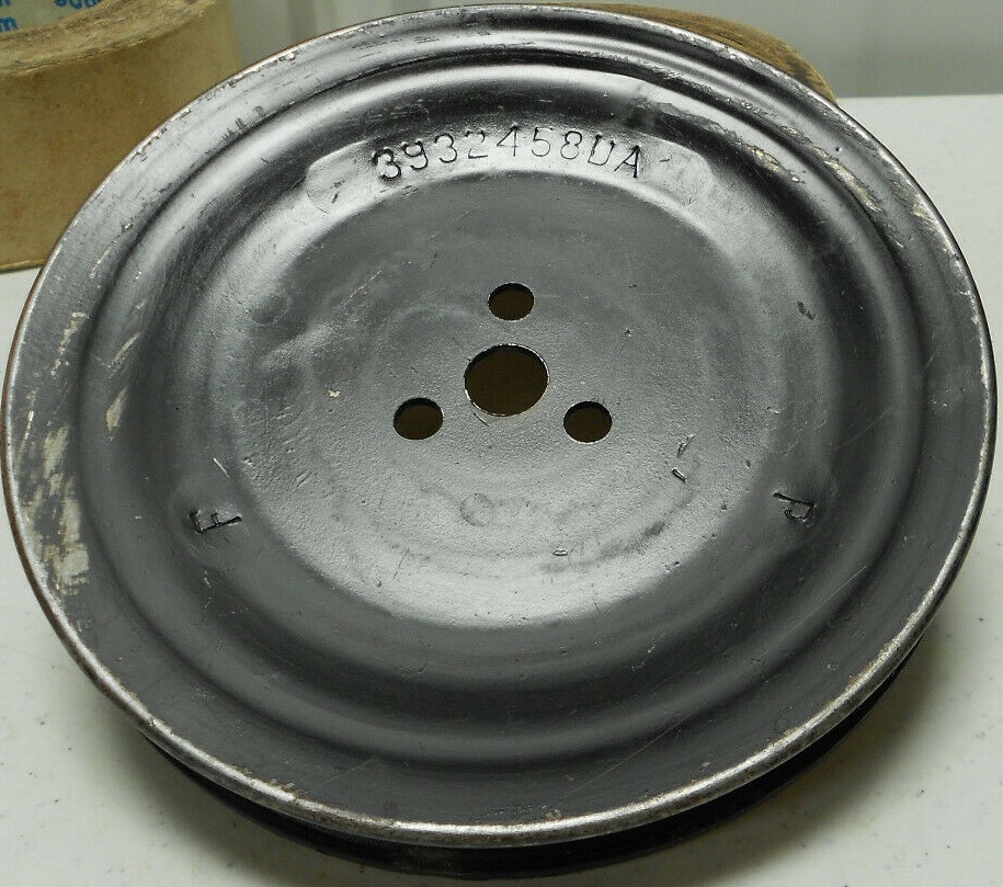

More samples from eBay today

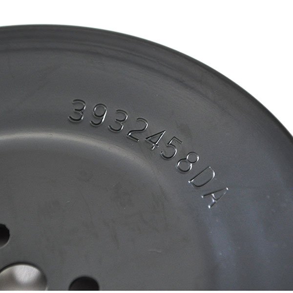

partsplace inc Reproduction
does not look like mine
