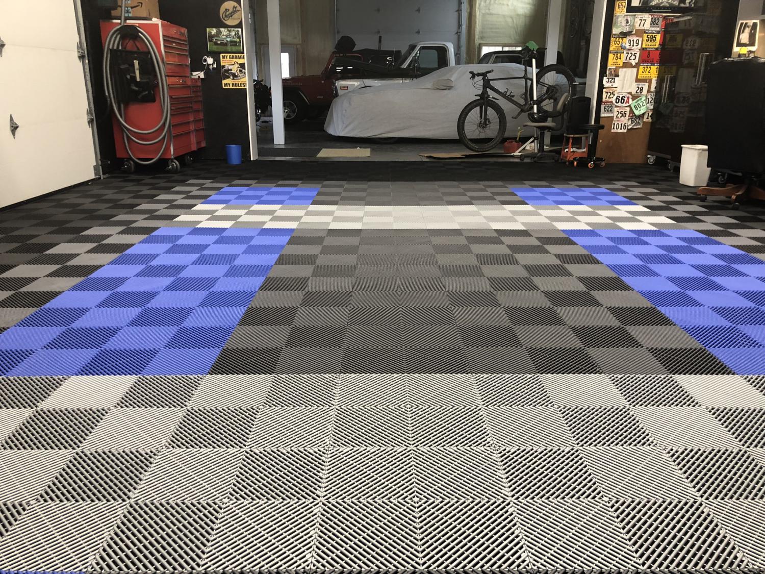

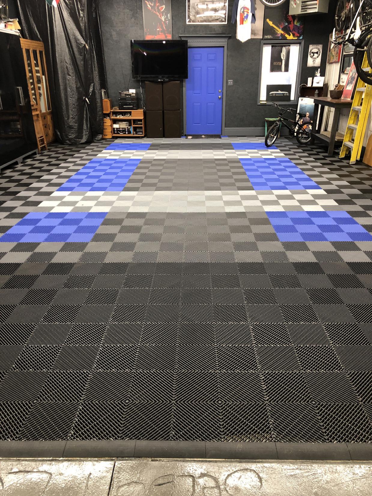

I went w staind concrete w an epoxy clear in one area and went with racedeck in another
Happy w both

James; how about some pics?
My only beef with racedeck is that I want to be able to wash the floor from time to time and just squeegee it off. Spills are inevitable for me (maybe I am just a klutz).

The area I use the racedeck is an area I don’t work on cars. I know you can get the RD in solid large squares that is easy to clean from what I understand.

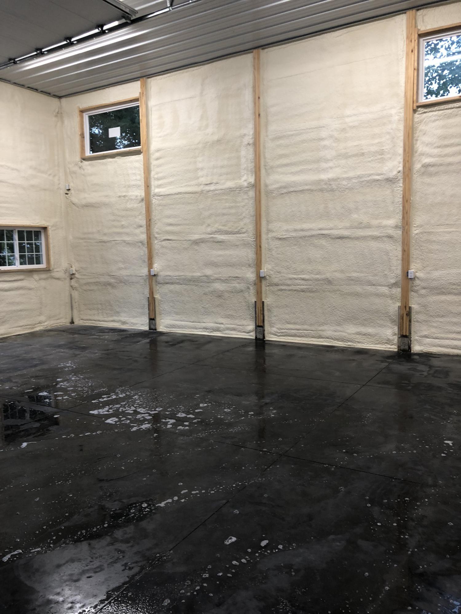

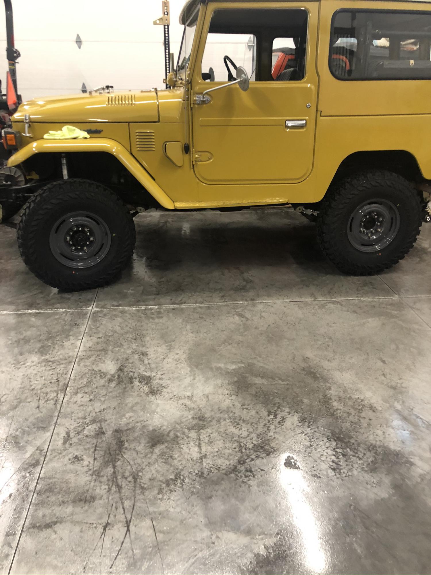

The epoxy brand I used is Ghostshield and is a 2 part process. I have been very happy with it
The pics show the floor in the cleaning process and then sealed
