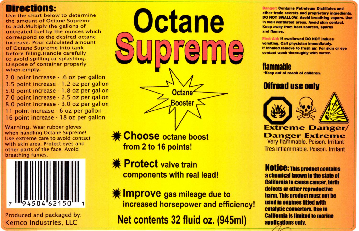

Default Octane Boost
I also run 100 Low Lead (actually more lead than leaded gas back in the day) from my local Executive Airport. It's a decided difference in my 69Z 302 which has issues with 93 pump gas. I also have great luck adding tetraethyl lead.
Available from Wild Bill's Corvette. Don't get it on your hands. I find it works as good as the avgas and much more convenient.
