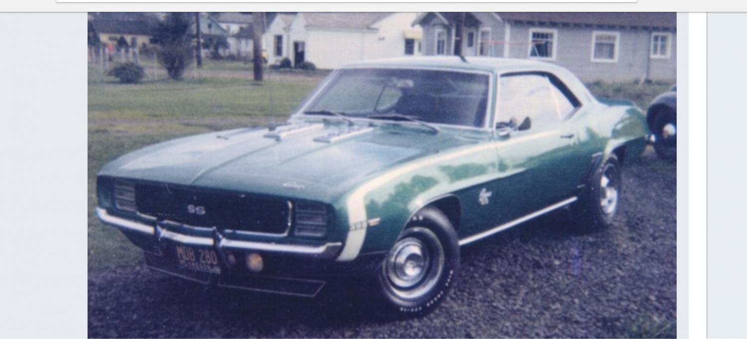

I tried to buy this off ebay a few years ago. This is an old picture of it, early 70s maybe. It was not this nice on ebay. Anyway, it had dog dish and trim rings. RS SS L78, deluxe interior. It was quite the machine
