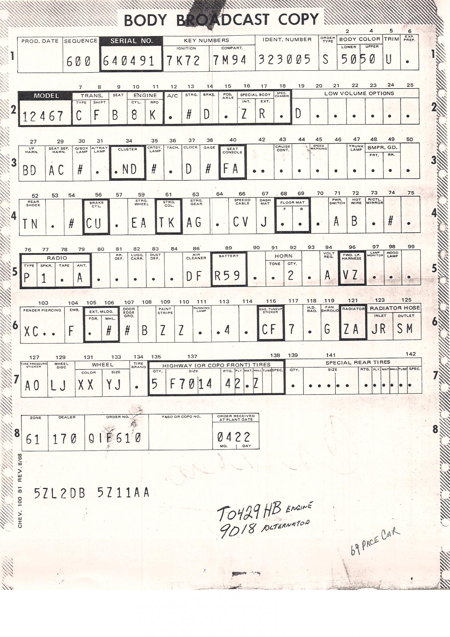

Default Nice #s '69 Z/28, Docs
Wish the seller would have provided pictures of the docs and engine/trans stamps. Looks like a good car that still seems to retain its original seat covers and door panels.
Link to 1969 Z/28 auction
124379N653589
Attachments - The Supercar Registry Ra78885598768c9b12758d1ebea70824e.jpeg My Pace Car Broadcast 640491.jpg Firebird VIN.jpeg 124379N653589 Tag.jpg

Broadcast sheet on a Norwood car gives me pause.
Note that there a 2 types of broadcast sheets. Body and chassis. The one typically found on the gas tank of LA cars is the chassis broadcast sheet, which would have traveled the chassis assembly line taped to the fuel tank before the mating with the body.

http://www.camaros.org/forum/index.php?topic=19225.0

So the link to CRG says the docs are repro.

I sent the seller a message with the link to CRG.
He's still in denial. Even after I pointed out some of the errors.
"They are not reproductions, they are copies of the originals. The originals will go to the new owner."
Just a lawsuit waiting to happen....
Looks like pics of all the docs have been removed from the listing.
I also don't see any pics of trim tag, carb stamp, engine stamp, etc.
