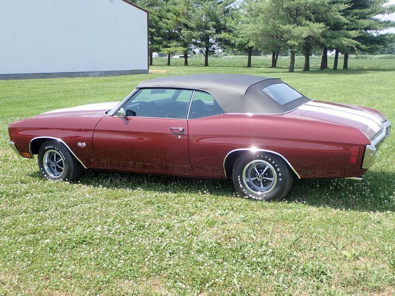

I would love to know what exact springs people are using to get them to sit correctly. As of late we have had nothing but trouble getting these cars to sit down where people like to see them. I have 4 cars in the shop and all 4 sit at this height. ALL have original assembly line springs in them on all 4 corners. Two of them still had the tags on them when they came in as well as original assembly line shocks but sit high. I have tried several different Moog springs and am now onto trying Eaton springs. We have also done all the math with the vendors to try and resolve it and have a TON of money in both labor and spring cost and have not been able to get them to sit right. Been doing this for 40 plus years and these last 4 cars are killing me.

They all sat a little lower but not by much and still higher than most would like to see. I cannot stress enough, all had original 50 year old worn out coils and two cars had original shocks.
We tighten the suspension when the car is a rolling chassis and no body. We then pull it down while on a 4 post hoist using ratchet straps and take measurements where prescribed in the book and then tighten all the bolts. I have been doing it this way for years. I am really getting frustrated as it is prohibiting me from delivering some of these cars.
I just received my Eaton coils about and hour ago and they are 2" shorter than the other 4 original sets so we shall see where that puts it. If that works then I have to figure out how to lower the fronts the same amount but should be easy using the same formula. Just a pain to have to tear four front ends apart to replace front coils.
The one pictured looks good but is still about 1.5" too high.

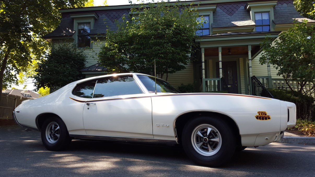

I have been using Hotchkis 2" and 3" drop springs to get a nice ride height. This Judge has a 2"drop spring.
Jay.

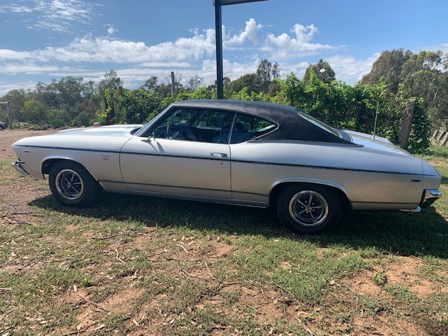

I tried 2 other sets of front springs for my Chevelle before trying the set of 2" lowered fronts springs I had sitting on the shelf for 3 years.
Never thought they would be the answer but I think it's pretty close.
